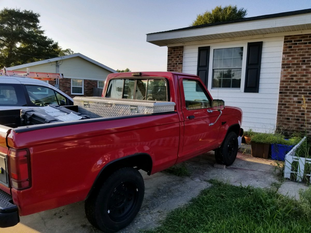

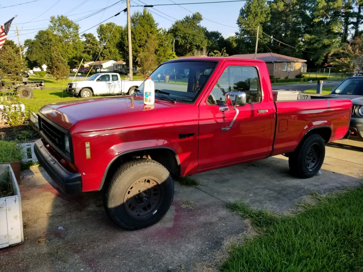

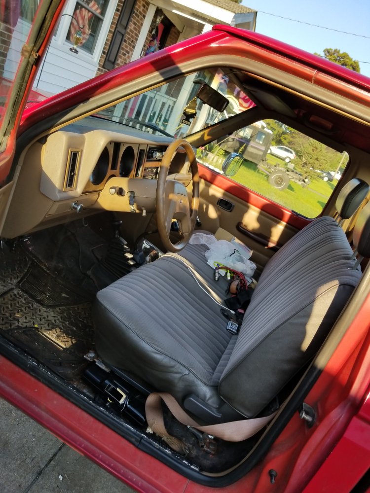

I should have just put a 302 in it like everyone here has done. I'm kicking myself for putting all the parts I have into it. It's just such a dam good looking truck. Love the first gen body style
Here she is. Before I blew a head gasket.
