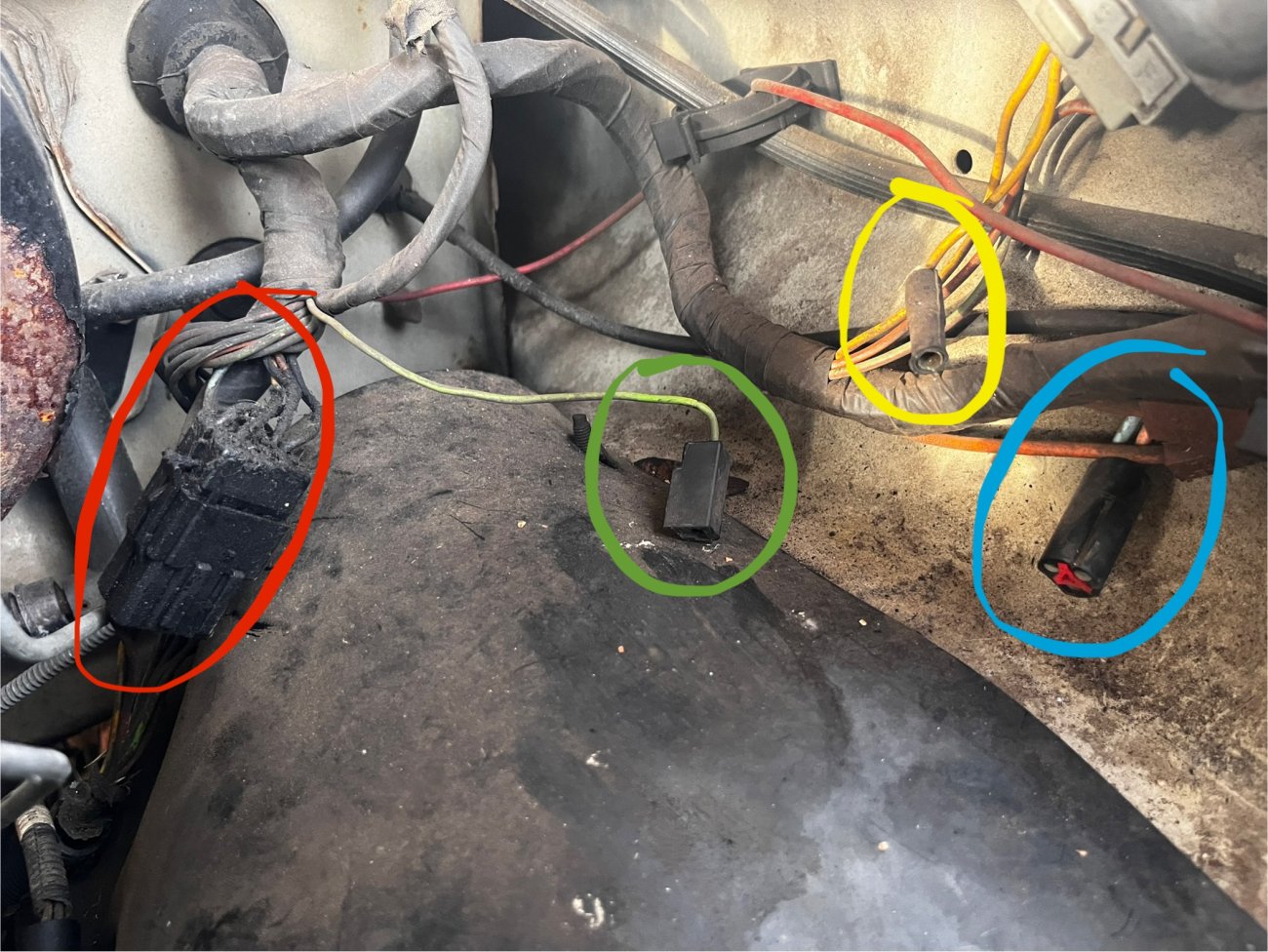

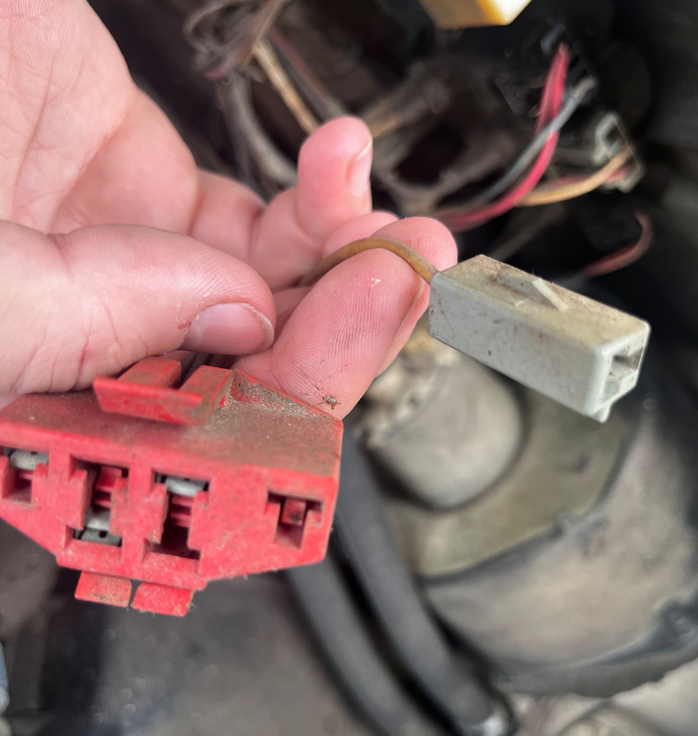

I was hunting around the engine bay for various foibles and found these connectors in the passenger side of the engine bay missing a friend.
Both connectors are wrapped together in the same collection/strand. Nothing in eyeshot for them to hook up to.

Any ideas on what they may be or where the opposite ends might be? Again, nothing in the engine bay, glove box, or passenger footwell that'd match
OBD1 test ports. They are not hooked up during normal operation of the vehicle.
Only used during testing with a reader.

@ford4wd08 Thanks for the input. Makes sense on the ignition switch being the culprit. Every fuse looks to have been replaced recently.
Is either the green or the blue connector the engine sensor plug you're referencing?
Focus on the connector circled in Red, there are some plugs on the driver side fender that are not plugged up as well.
I still would start inside with the ignition switch and cross it off the list.
Green wire looks like a prepackage to cruise control which I don't have.
Yellow should be the test port for the voltage regulator.

Yes I forgot the G2 alternator had an external voltage regulator on the fender.

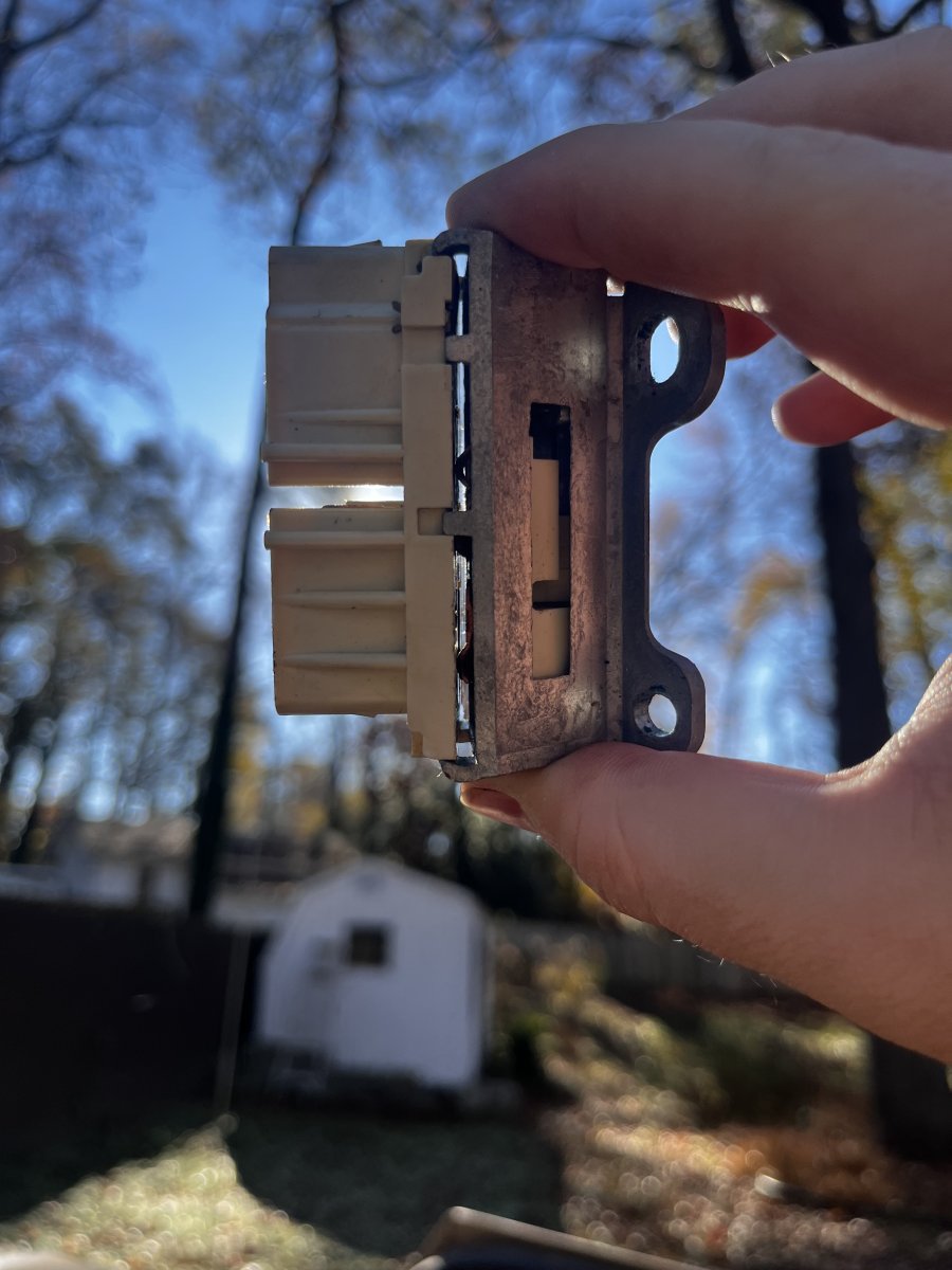

Ignition switch worked! Turn signals and backups are working great now. Thanks @ford4wd08 !
The old one was literally split in 2 after I removed it and you could see the corroded contacts.
Thankfully it had the tamper-proof star bolts so no cutting was necessary. Must've been replaced before.
For reference: Multimeter read no voltage across fuse terminal 5 at idle, with turn signal, and in reverse.
interesting,,, the one circled in blue has been asked about in recent posts. no definitive answer yet.
'85 was a transition year as they got ready for the EFI 2.9 L.
A lot of the wiring harness is similar. Ford just kept adding wiring harness vs redoing the whole harness from scratch.
That's how you can do the duraspark on the '85 and just remove the harnesses to the computer and emissions equipment and the rest still is there and functional.

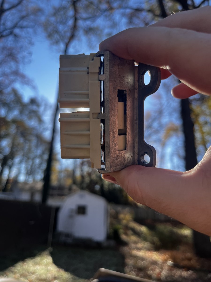

I fought mine for a while. Would engage starter and turn over the engine, but would come loose in the run position. Threw me for a loop for a while.
