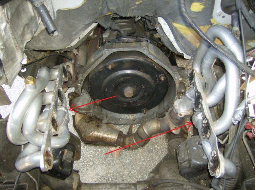

....Torque Master headers and the AFR's.....
That reminds me... As delivered, the TMH's will not clear AFR heads. The AFR's have a thick, continuous outer flange where the factory iron heads had indentations between the outer head bolts. IIRC, the major points of interference were at the collector on the PS and at the small 2-bolt flange on the DS. A little machining and/or filing makes everything OK though.
I wouldn't be surprised if this was also an issue with other aftermarket heads. The TMH's are tucked in so tightly that even valve cover clearance can become an issue. I had a really nice set of fabricated sheet aluminum covers but they weren't even close to fitting with the TM's in place. Had to revert to more conventional cast Cobra covers to make everything live together in harmony.
The first photo shows the approximate locations of interference.

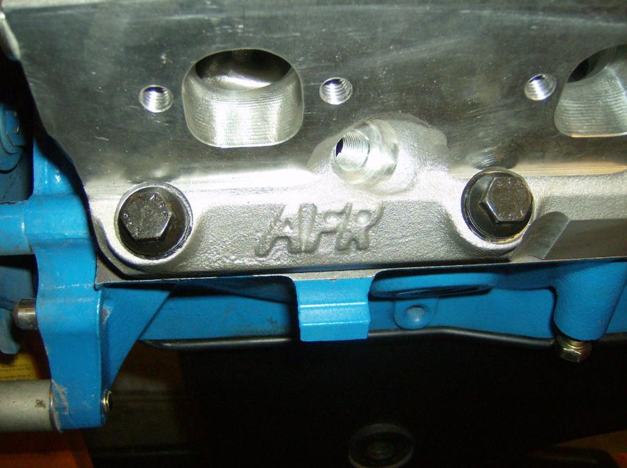

Looking to the far right in the second photo, there is a short area that has been milled to allow the outermost edge of the AFR to clear the PS collector and its weld. I thought I had other pictures of this but I can't find any.
