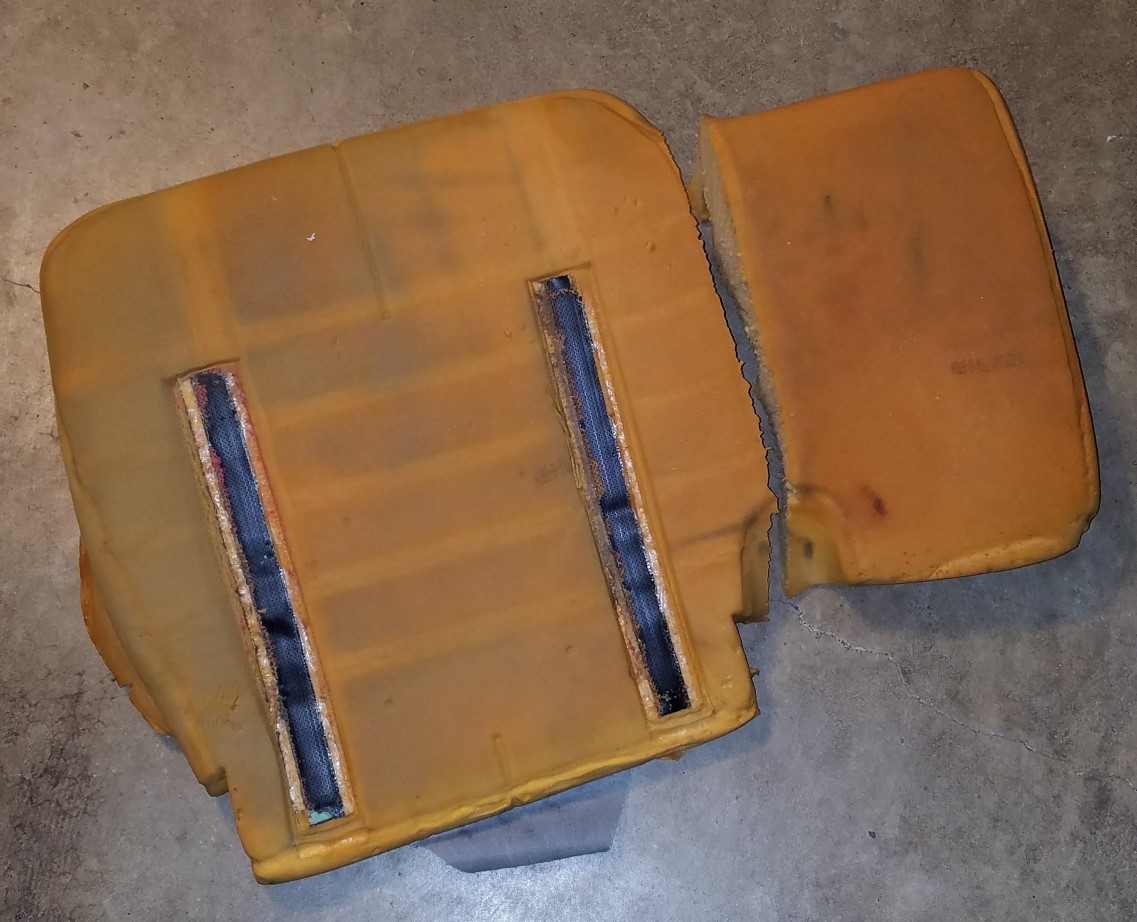

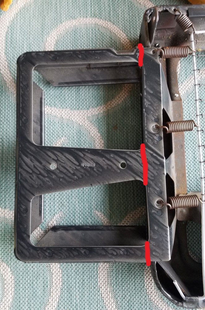

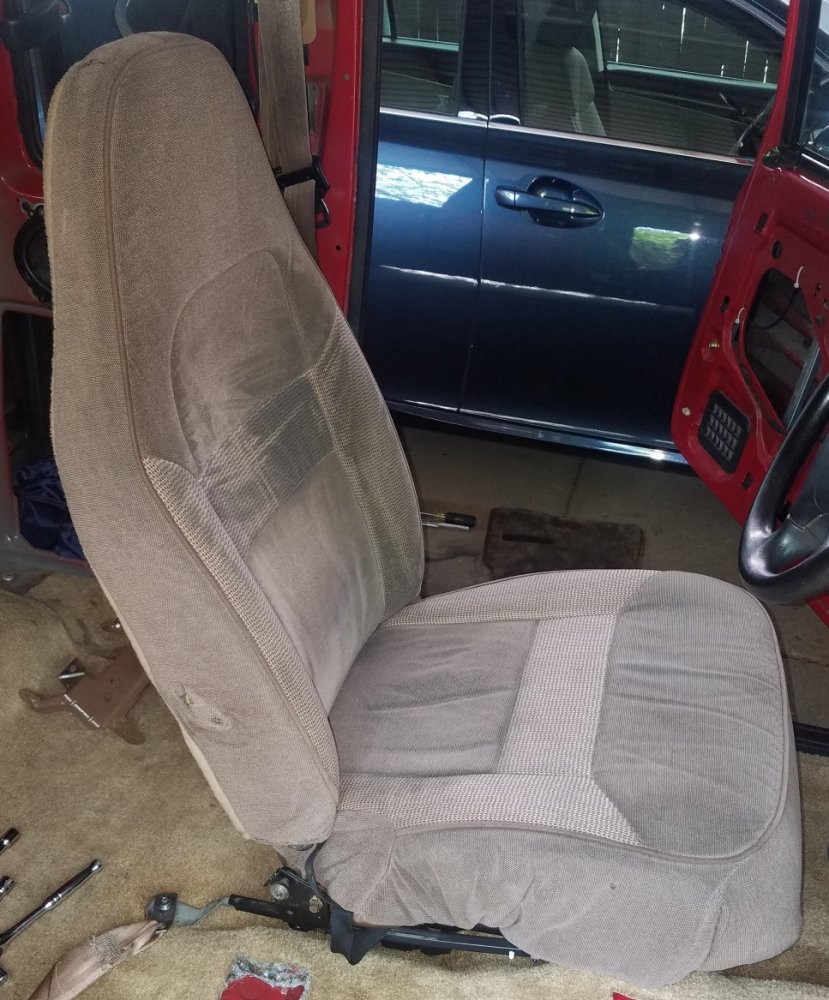

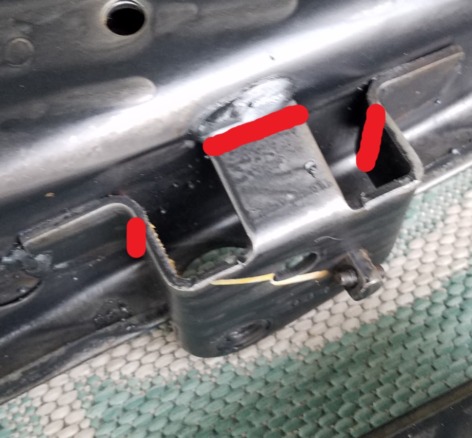

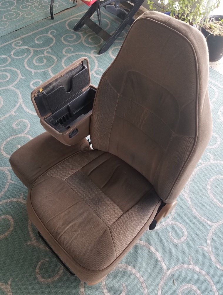

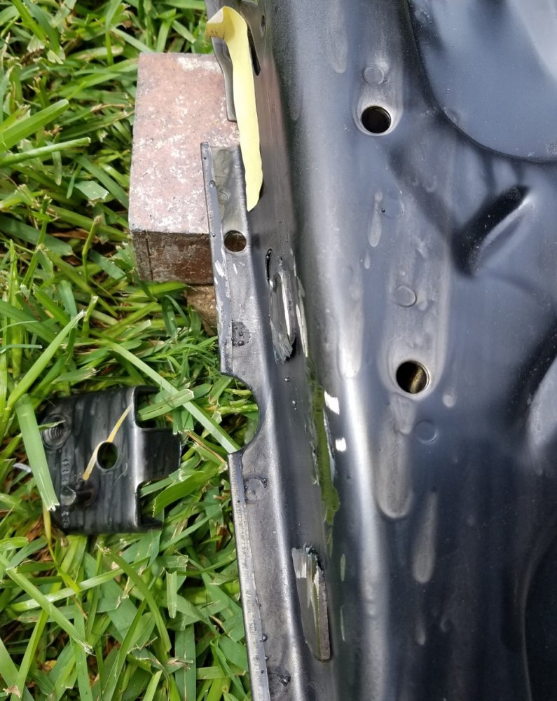

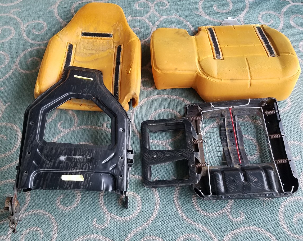

Simple 60/40 seat cut to bucket seat. First pull out driver side 60/40 seat. Remove track, bolt on each side to remove back from seat. Remove seat belt, remove bottom fabric and pull off the padding. Remove arm console on back of seat, remove fabric then padding. Put the fabric in the washing machine. Cut the 60/40 seat and also the bracket on the back that held the arm console with a grinder on the red lines. Cut the foam padding 60/40, I used a bread knife and cut it like a loaf of bread. Star putting it back together. Padding on metal, then fabric over the padding. On the seat, take the excess fabric and just fold it around tight and put the track back on. You wont see this or the hole in the back where the arm console used to be cause the new console will block it from view.
