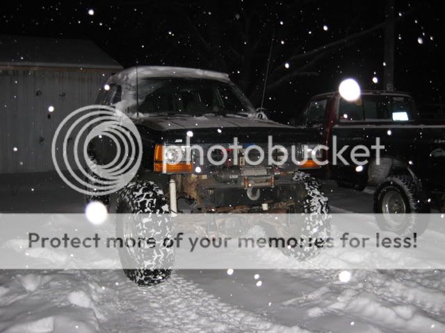

But its a 1986 with the 2.9L mitsu 1350 d35 ex8.8
Duff Leaf springs, Duff Coil Buckets, Duff Radius arms, 8" XJ Coils, 35x14.50 15 boggers......its not finished yet. Still needs shocks and steering work. But the motor and trans are about shot.

got the rear shocks mounted tonite, truck should be streetable. Need to lengthen the rear driveshaft before i can wheel it though.

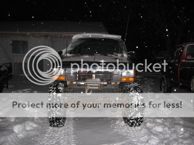

Got the front winch mounted and did some trimming.....i need to extend my rear driveshaft 2"s tomorrow and she shall be wheelable.

I still have plans to widen the front bumper and some more changes in that area.

Yeah i didn't get around to making my driveshaft last nite, so i'll be doing that today at work when i have down time. But i did repack my front bearings, but their toast, so i'll run them for now and replace them in a week or so. But my damn LF hub is racheting so i think i may put the drive slugs in it tonite and buy new hubs shortly. Test Run is tonite, hopefully no issues. Thinking i may get the 35" BFG MTs to run on it tonite. Scheduled for like 4-6"s so the trails should be fun with all the ice under the snow lol.
Just got back from some snow wheeling/shakedown
I got a klunk under my floor, i think its the tcase hitting the bottom of the truck. I'll have to check the trans mount.
