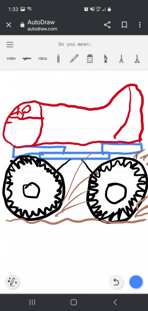

Fabricating simple yet effective 4x4 "mud truck" frame
