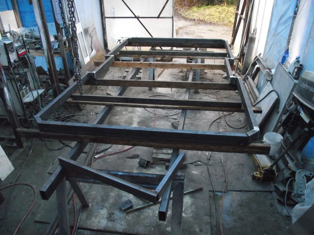

building a quad trailer for a guy,he wants to put three quads across the deck,side by side.
he's got a car dolly for the axle,but it's 78'' between the wheels and i want the deck a little wider so the quads won't be hanging over the edge.that's why the square kick-in is in the middle(these are the side rails)
i've also found that when walking around trailers like this i have a tendency to bump into the corners with my knees,so i like to miter them to a short 45*,just enough that it isn't sticking out so far.
Fabricating anything right now?
although i used my little mig to tack the pieces together i'm doing all my finish welding with stick,using 7018 1/8'' rod.this is a good high strength rod with good penetration,and is cheap to weld with and easier than dragging the wirefeed around.
the frame is 2x4x1/8'' hss,and will have 1 1/2 x3 x1/8'' hss crossmembers ,as well as a 1 1/2x1 1/2 x1/8'' angle iron ledge to hold a 3/4'' plywood deck flush with the top of the steel.
i'll post more as it progresses.

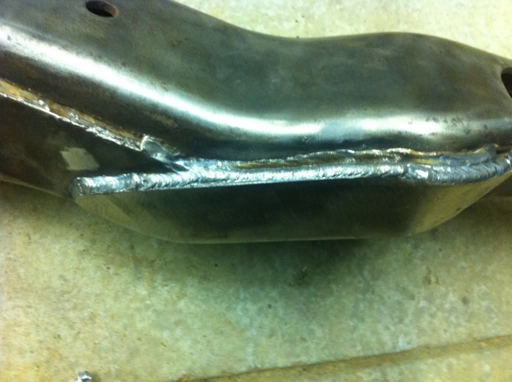

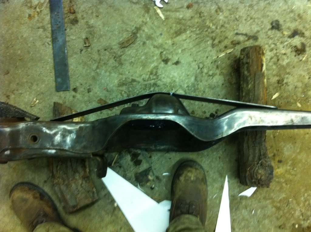

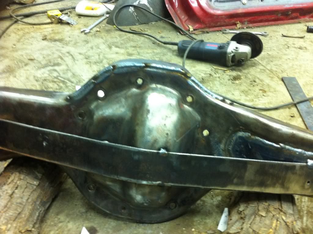

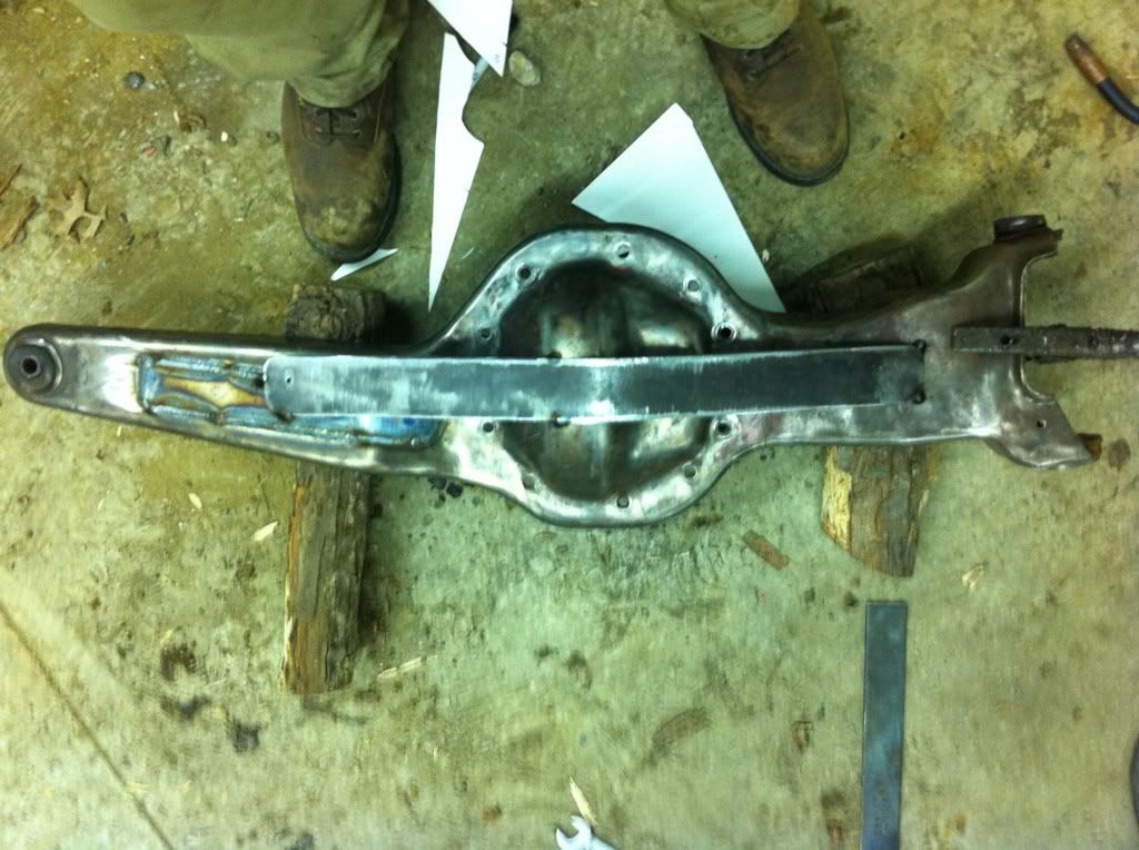

been welding up my d44 ttb brackets the last few nights...
nice work:icon_thumby:
got some more trailer frame work done....

the frame laid out.....the angle piece in the forground is a corner jig to get the corners welded square.

the corner going together.

and the frame assembled.still a lot to do on this,but at least i have the basic shape now.
excellent work GWAII, if you didn't have that welder in your hand I'd start to worry that something serious happened.{ i bet you suffer from withdraws when there's nothing to do?}
there's always something to do......i've got projects lined up to fill the next 5 years,and by then there'll be plenty more:icon_thumby:
(mind you,when i travel-which i don't do much-i get a bit antsy)

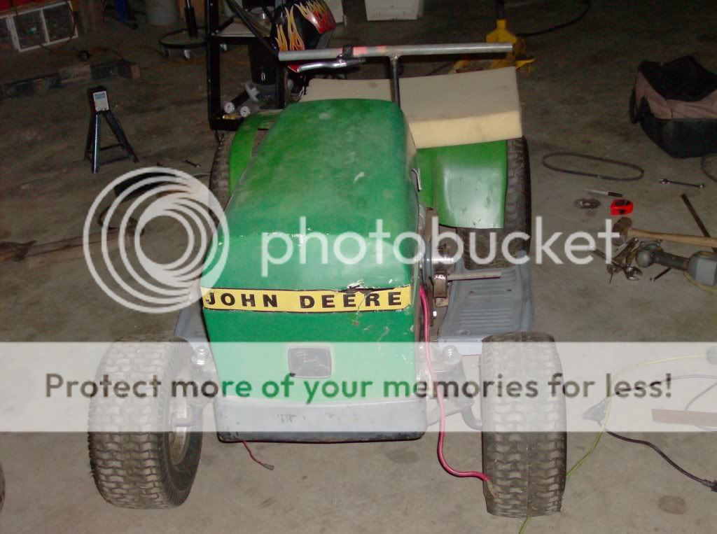

updated pictures of the john deere mower im custom building.
specs:
16hp v-twin OHV vanguard
belt/chain drive
no gears just let out the clutch and go!
custom made seat
hand throttle
belt foot break
then just a bunch of custom made brackets and stuff to bolt shit to
enough talk onto the pics
