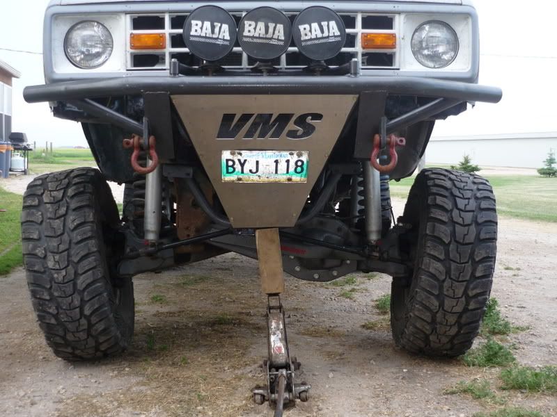

Here's one I did:

This truck has 8" coils on it. Ideally the centerlink on that should've come down another 2 inches or so, but with that much lift, you kindof have to make a compromise due to the added leverage it puts on the Superlift idlerarm.
Being standard TTB coils, it handles quite acceptably.
