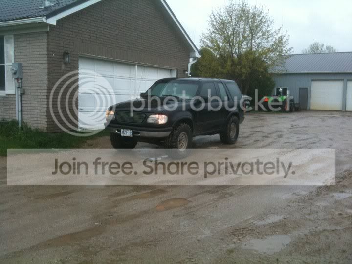

Explorer sport build
This is what it looked like right after I put 33 12.5 tires under it stock with a little bit of torsion twist.
