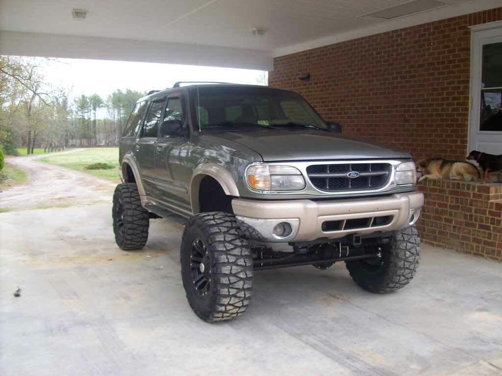

The pictured Ex below, has stock 5 leaf Waggy springs, but was reported to have settled 3" with a 4.0....
The springs I had in mind were the 7 leaf 2.5" CJ/YJ Superlift...
What I got...
What I'm going for, except w/ 20"s...

Well... At first I thought your truck was taller than what I wanted, but then again... I have a SUV with a V8, and my running boards and fender flares will make it look lower.
I pictured your truck, when it was on the 35"s with the flares and boards, I think that might be about right... Right? And it would probably only squat about an inch or so being as the spring rate is 300ppi...?
