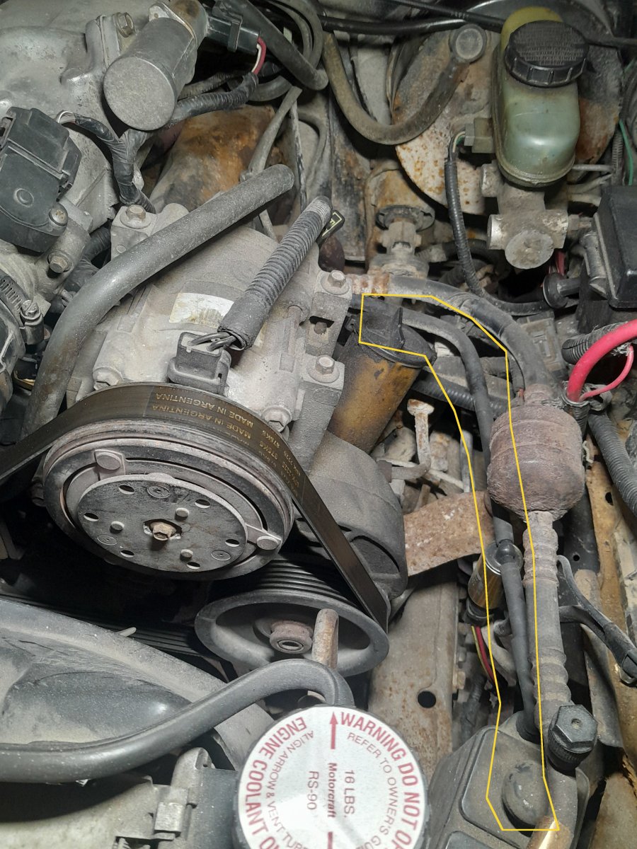

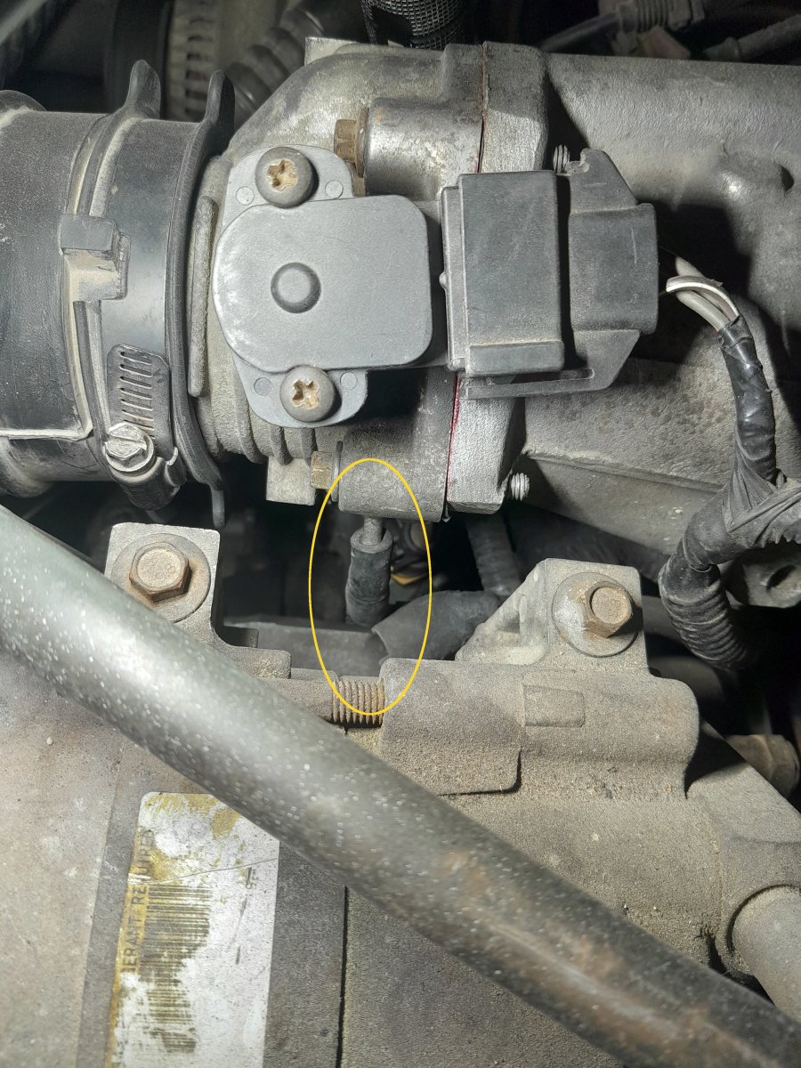

On my 94 4.0 it runs to the intake manifold up near the throttle body. If I cna find the image I'll post it in a minute.

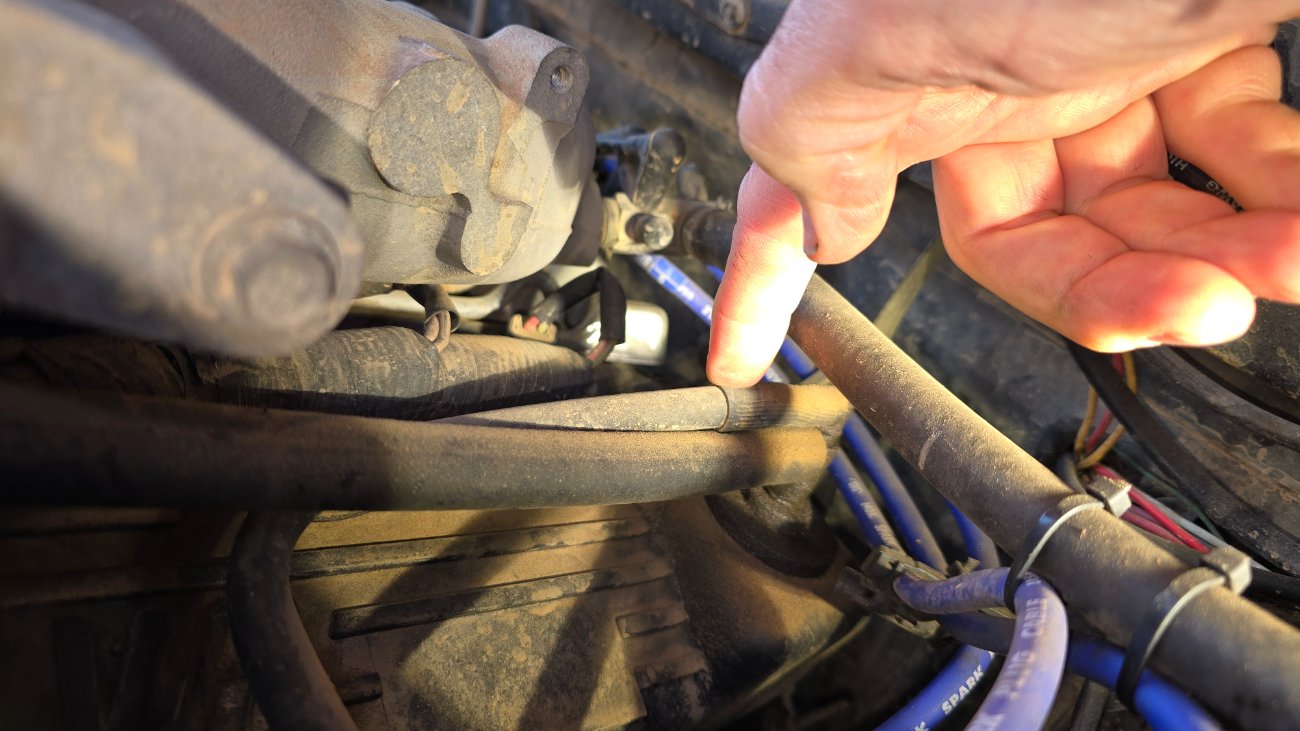

On my '93, the PCV valve has 2 outlet nipples. The the evap canister line is attached to the upper nipple.
Pointing to the evap line, above driver side valve cover.

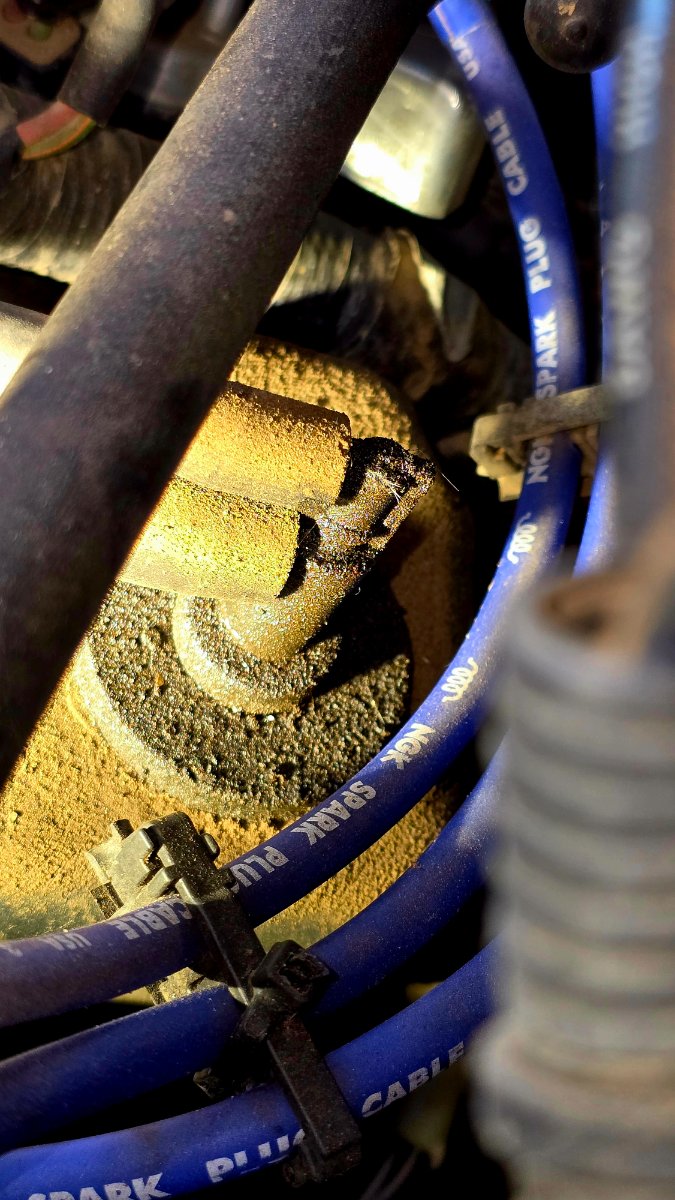

The PCV valve, complete with dust and dirt from Colorado and all states between here and there.
