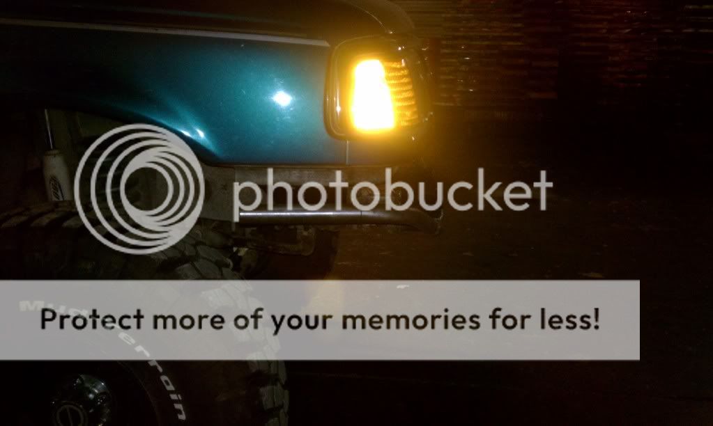

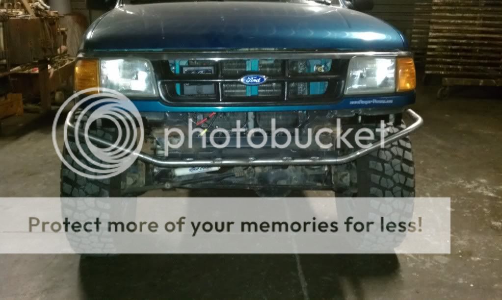

Some work done on the bumper. Went to get the tubing, cut it up to the lengths I needed for each piece. Went to my friends that runs a fabrication shop and got to work. Spent most of the time discussing ideas and then started bending.
Here is what was done. The pics suck. Sorry.

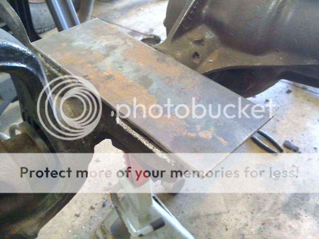

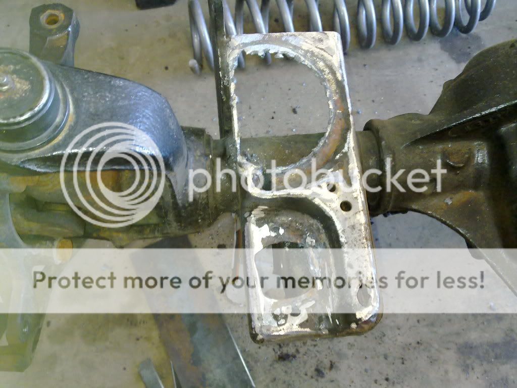

Here is what I got done today...

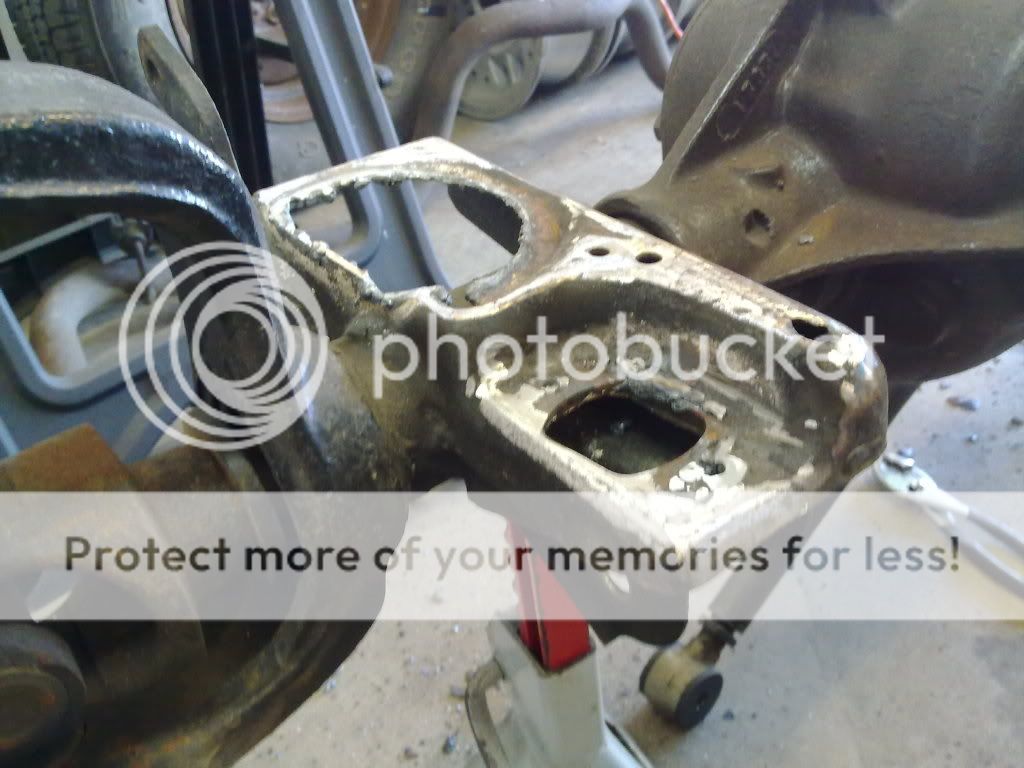

Cut the coil retainer off the axle...
Escorts 2nd SAS
Escorts 2nd SAS

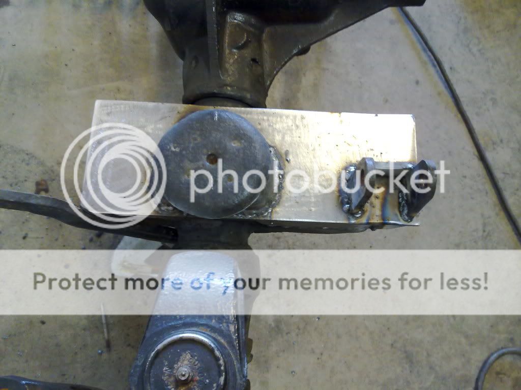

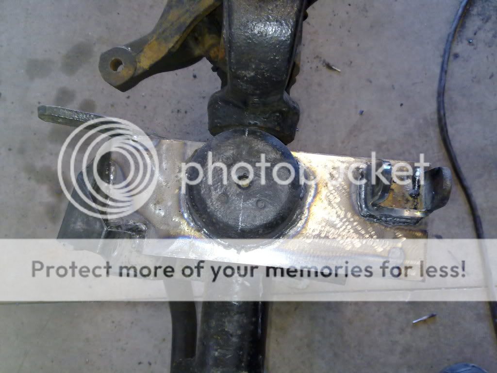

Then welded this plate to it....
Escorts 2nd SAS

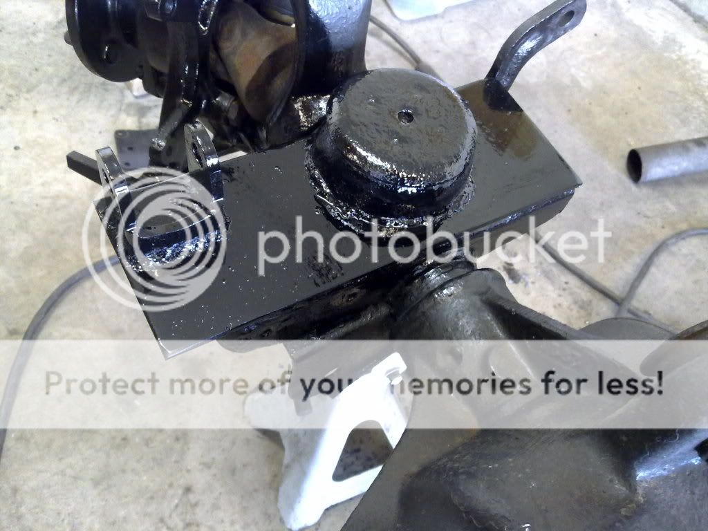

Then welded the coil retainer on top of the plate, it's now centered on the axle...have the shock mount welded on too...
Escorts 2nd SAS
Escorts 2nd SAS
Painted....
Escorts 2nd SAS

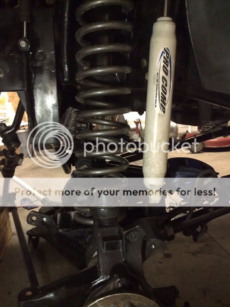

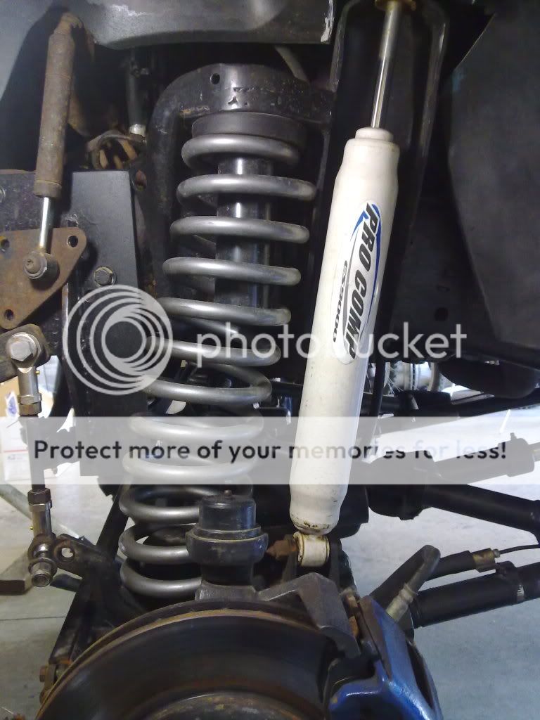

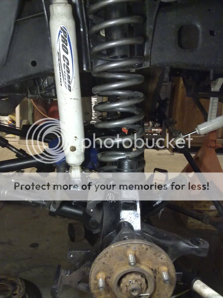

All put back in, looks much better now.
Escorts 2nd SAS
Before
Escorts 2nd SAS
After
Escorts 2nd SAS
Only took me 6 hours. Take it for a drive tomorrow and see how it does.

Thanks a lot for this pictures.
This will save me from lots of trouble when i start working on mine, since i have to relocate those coil retainers like 2" closer to the dif pumpkin, and now i know i must center them in order to have the axle centered and to avoid issues with the coils.
Thanks bud. :icon_thumby:

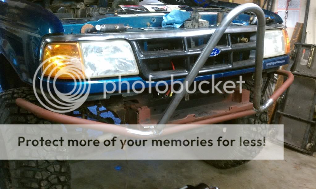

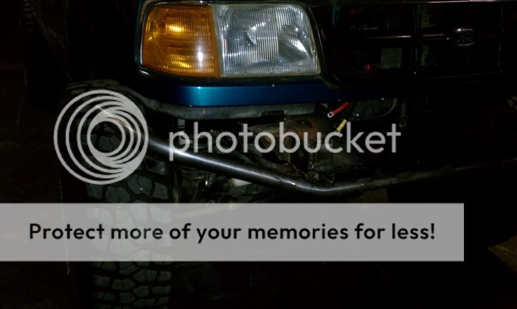

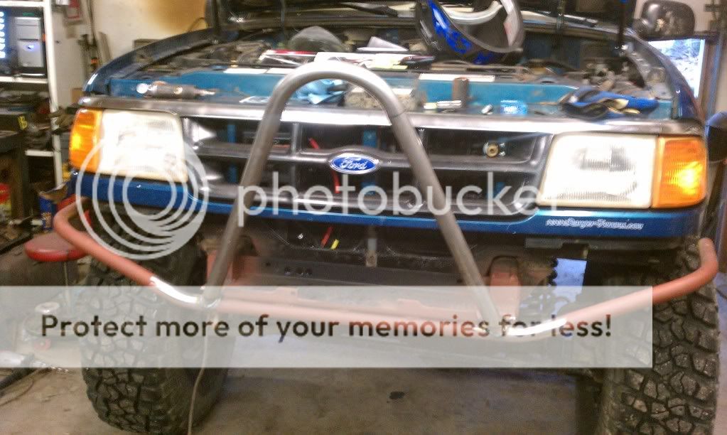

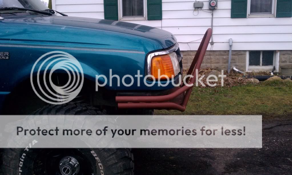

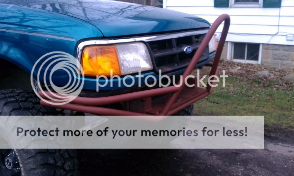

Finally got time. Friend finally got time so got some work done on the bumper...slowly but surely
Escorts 2nd SAS
Escorts 2nd SAS
Escorts 2nd SAS
Had to stop and pick up my son from school. So this is the stopping point for now.

love it. looks good.
Nice lookin bumper. I'm probably gonna copy it i like the design alot kinda looks like 97trailrigdd's. And i like how you modded your coil buckets with the piece of pipe another thing im probably gonna copy keep up the work everything looks amazing.
