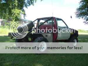

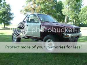

Look what my brother just bought off Craigslist.... He got the bug after riding with me to Bundy Hill. Lol
Escorts 2nd SAS
Escorts 2nd SAS
Sent from my HTC using Tapatalk
Now he just needs the RBV bug. As far as making a Toyota badass as an RBV, can it be done?
yota's can be a cheap capable budget build..
He got it for less than 900. It has a title but just not streetable. It beat up body but frame is good and motor runs good. Also came with lockers front and rear

Sounds like a good deal then. But is he going to try to make it streetable so that he can drive it to where he plans to offroad it, or is she going to be a trailer queen?

He was already looking for lights on eBay for it before he went and picked it up.
