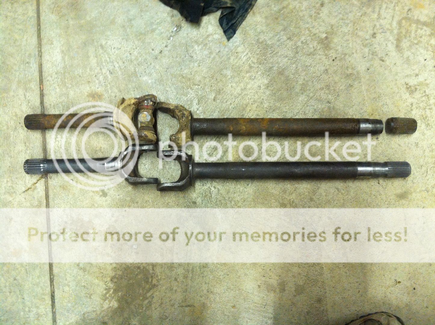

Go find a pinch point for one off your front tires, and romp on the gas, that should speed up the progress.
Thats what I did... LOL
