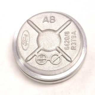

Under your truck, look at the passenger side of the trans. The exhaust might get in your way a bit. You should see two small metal covers- these are what cover the bore that the servo piston rides in. The covers look like this.
One is for the intermediate band, the other is for the overdrive. I.... don't remember which is which. I'll get back to you on that one.

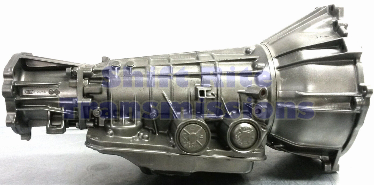

And here is an image of the passenger side of the trans so you know what to look for.
Eratic/hard shifting 5R55E transmission
Once you get a good angle, look for a two-letter code on the covers. The one above is code AB- one of the larger and later servo pistons. The two servos on your truck may be the same size, they may be different. All depends on how old the trans is.
Write down those two letters for each cover, that is how you will order the servos.
The other thing to do is to measure the bore with calipers- if the bore where the piston rides is worn out or damaged, replacing it won't solve your problem (at least not all the way).
Once you've found your servo codes, you are good to go!
