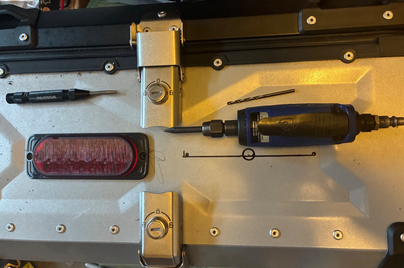

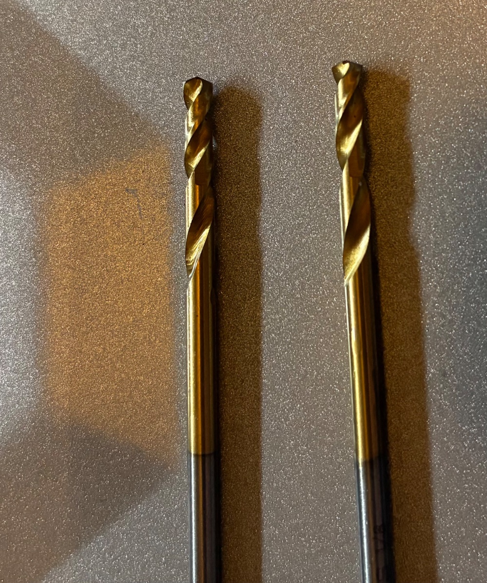

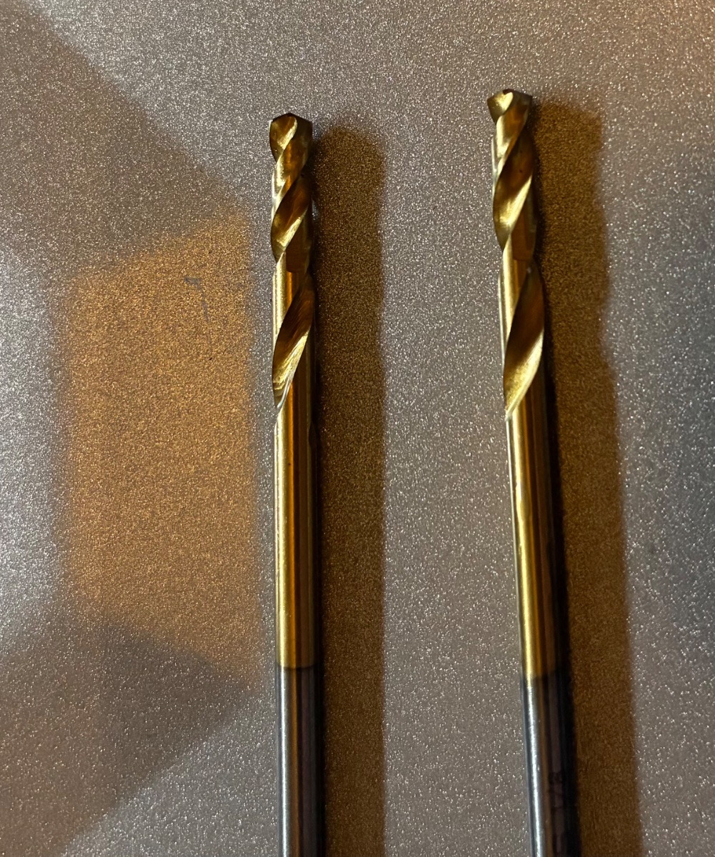

Left bit is the one I tried to drill with last night for several minutes. Brand new prior, and the one on the right is brand new for comparison.

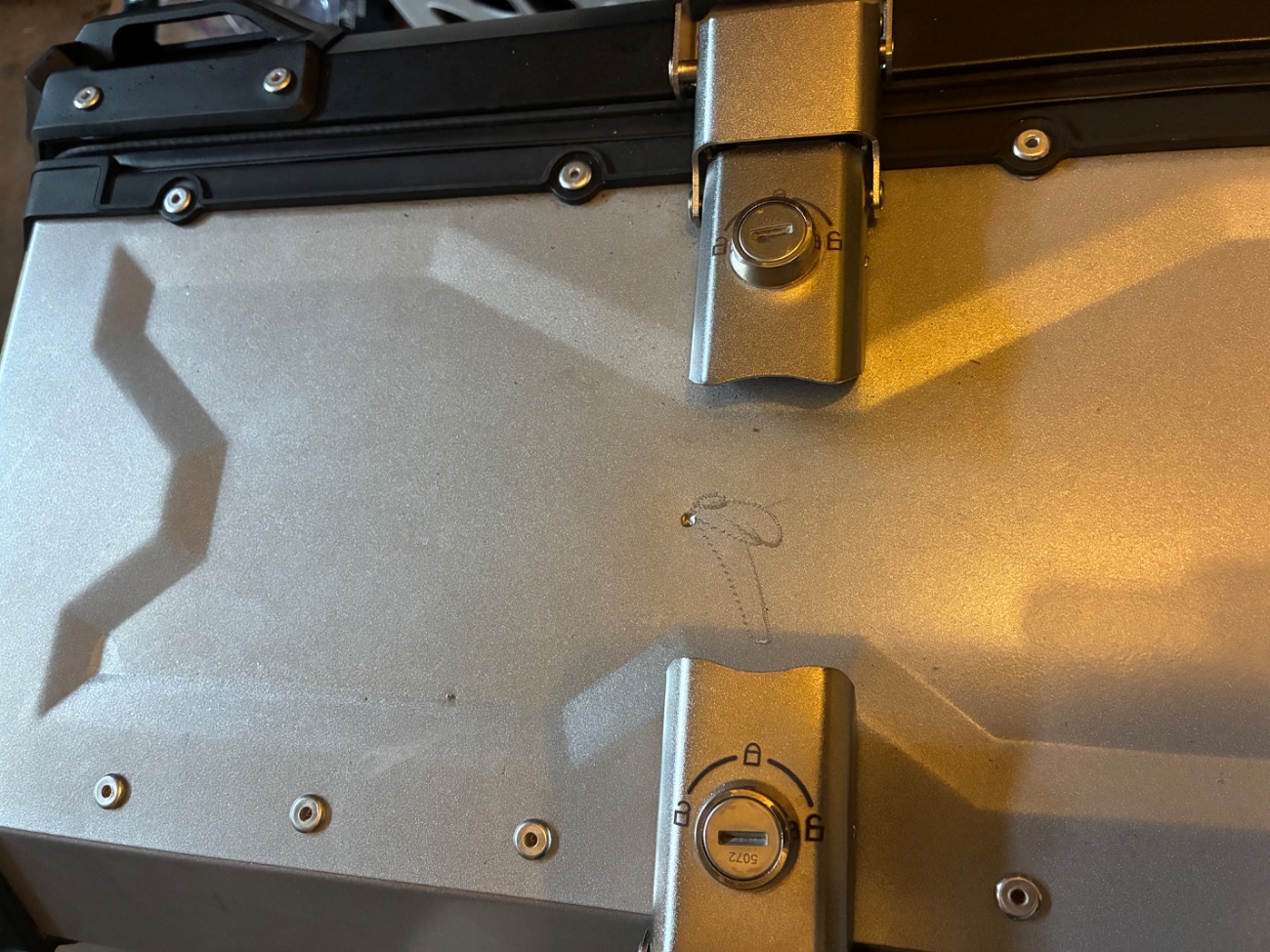

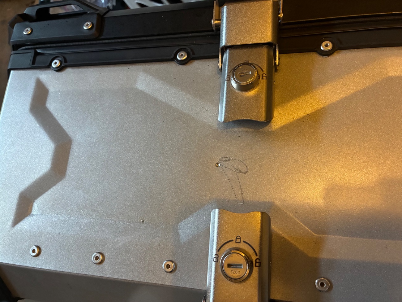

Second picture shows where I tried using my die grinder. It definitely chewed away some material but I’ll need to be more intentional about preparing to avoid scratches when it slips. Before and after doing that, I tried one of the new cobalt bits that came in the mail today. Still nothing… just blissfully spinning over the surface of the metal.
Second picture shows where I tried using a bit in my die grinder. It definitely chewed away some material but I’ll need to be more intentional about preparing to avoid scratches when it slips. Before and after doing that, I tried one of the new cobalt bits that came in the mail today. Still nothing… just blissfully spinning over the surface of the metal.

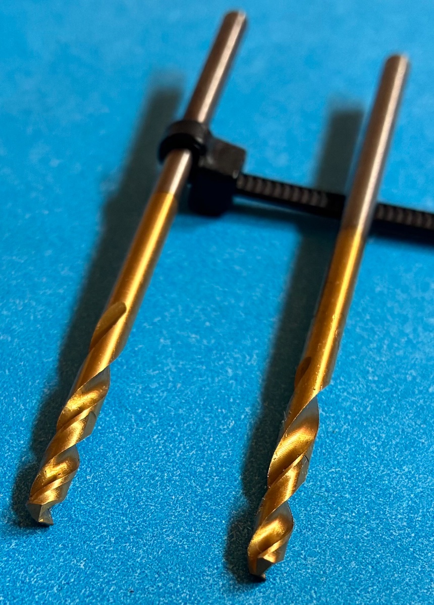

Any chance of a better picture of the end of the drill bits? Like the part that actually does the cutting.
I’ll try - struggling to get the phone to focus properly.

Black zip tie on the one I used, next to an unused bit.
Did you say these are 1/8" bits? They shouldn't normally need a pilot hole. But, have you tried 1/16"?
Those are 1/8, but yes - I’ve also tried 1/16.

If I’m willing to embrace the reckless approach, I can just open the initial hole directly with the die grinder and then hand straight off to the step bit. Just managed three more holes in about ten minutes that way.
