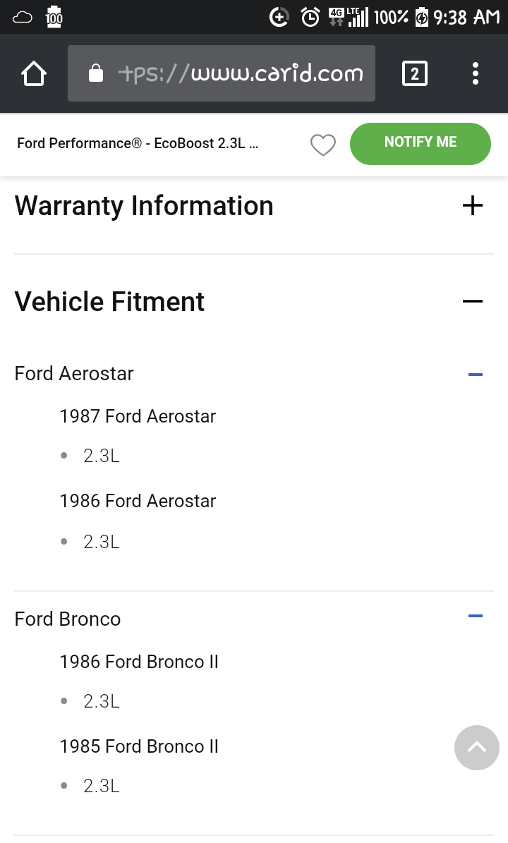

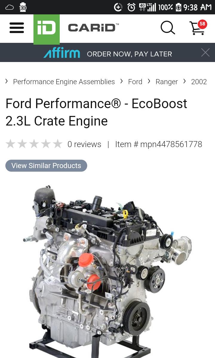

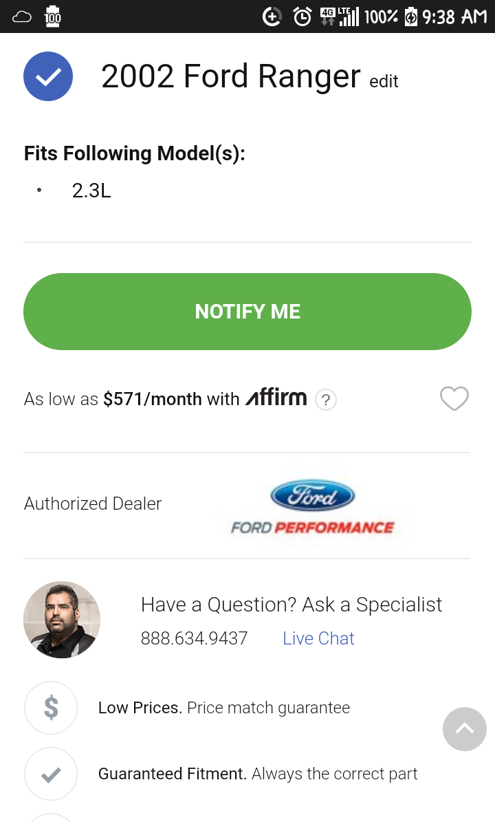

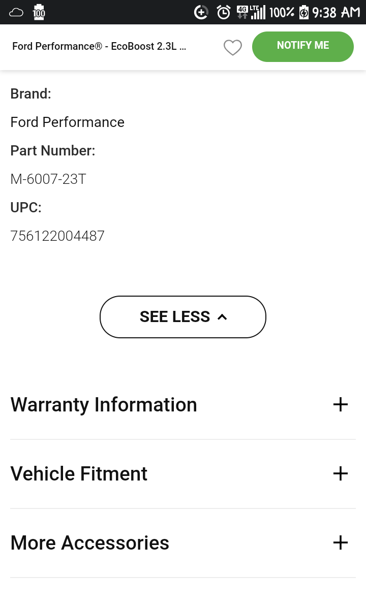

Here is the engine and fitments I was talking about. Found it on carid.com and can get it with better warranty directly from ford performance & cheaper.

Isnt that the NEW 2.3 they run in stangs and stuff?
.....and you thought putting in a 3.0 was gonna be hard.
Supposedly they say the engine from the 2015 to 2018 mustang that are equipped with the ecoboost 2.3 will fit which seems odd to me. Could I just get a bad body mustang and swap it all over drivetrain & wiring? Just fabricate a custom gauge cluster spot in dash and change out all wiring? Only body & interior a ranger but rest mustang? The money is not a problem I just want to make sure that I get amazing fuel economy but also plenty of power. I've driven and EcoBoost Mustang and an EcoBoost Focus and I really like the way it felt in the focus but with the Mustang you expect Extreme Performance so it kind of seemed like but for a 4-cylinder still had a good bit of pick up and go.
