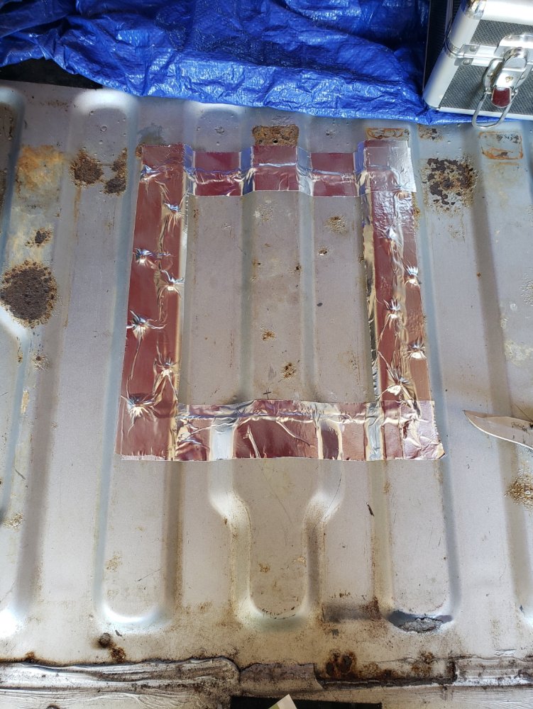

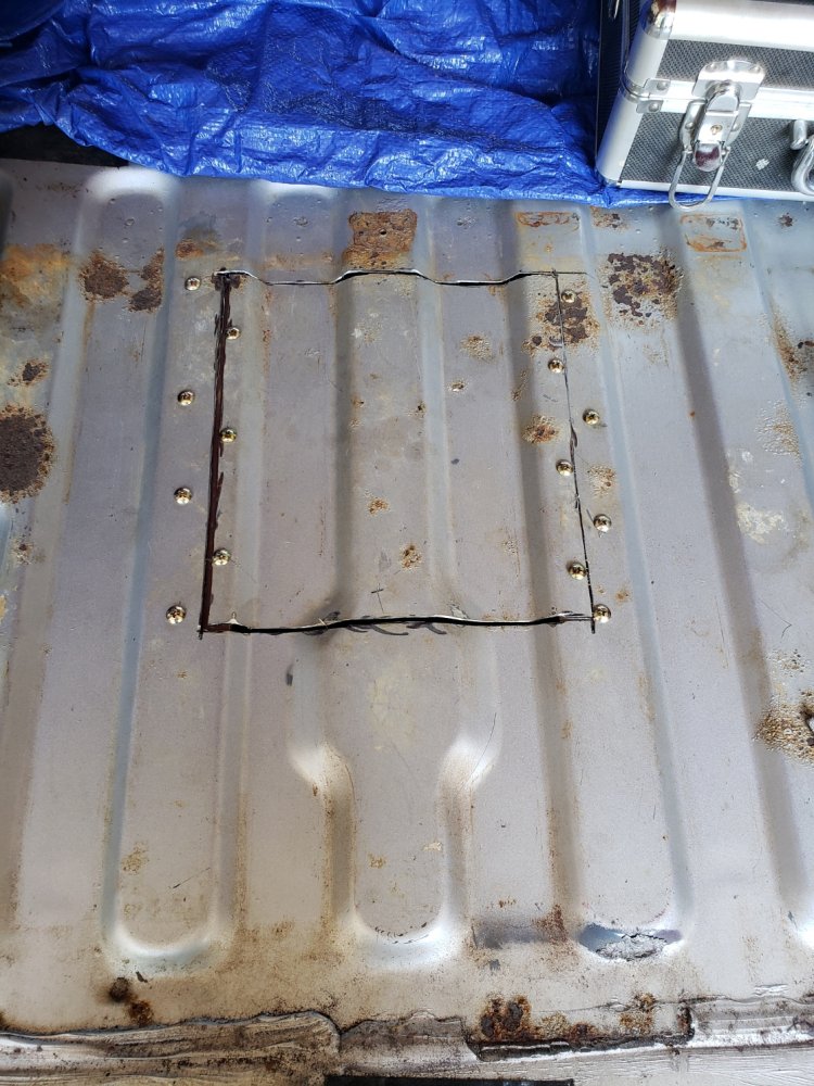

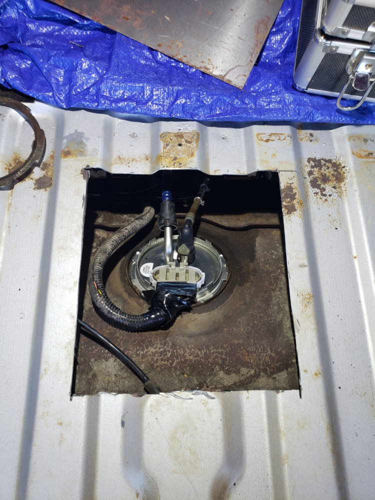

I finally broke down and created an access panel to get to the rear (in-tank) fuel pump.

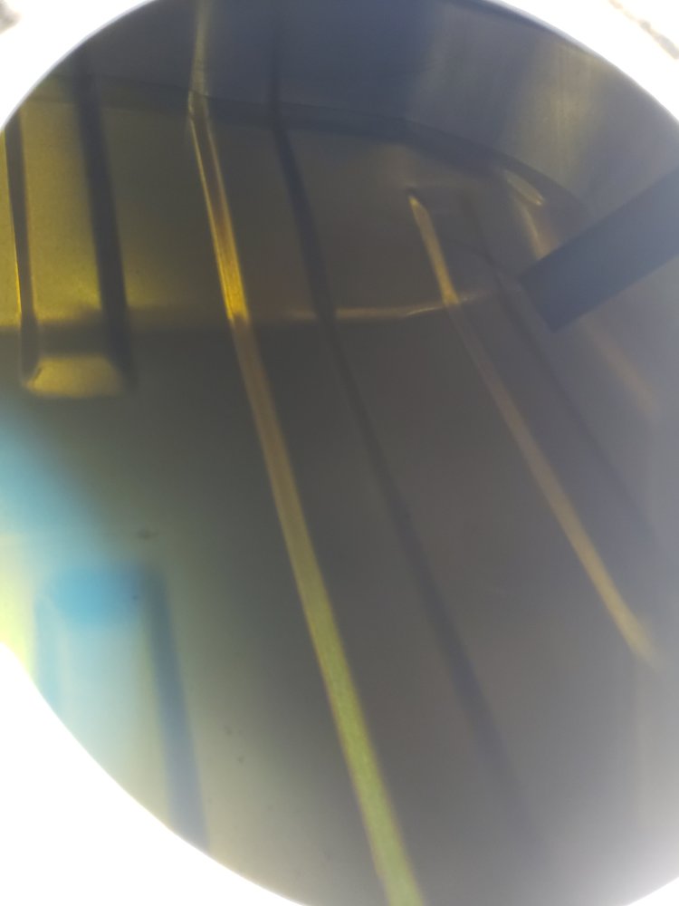

I was very surprised at how clean the tank was. Zero sediment but the fuel gauge had stopped working and the pump was making no noise so change it I did.
The gauge is good to have back, and I hear the new pump working. There is no change on the pressure measured at the fuel rail, but I am not able to measure it while I am driving, only in the garage.

Access panel creation:
