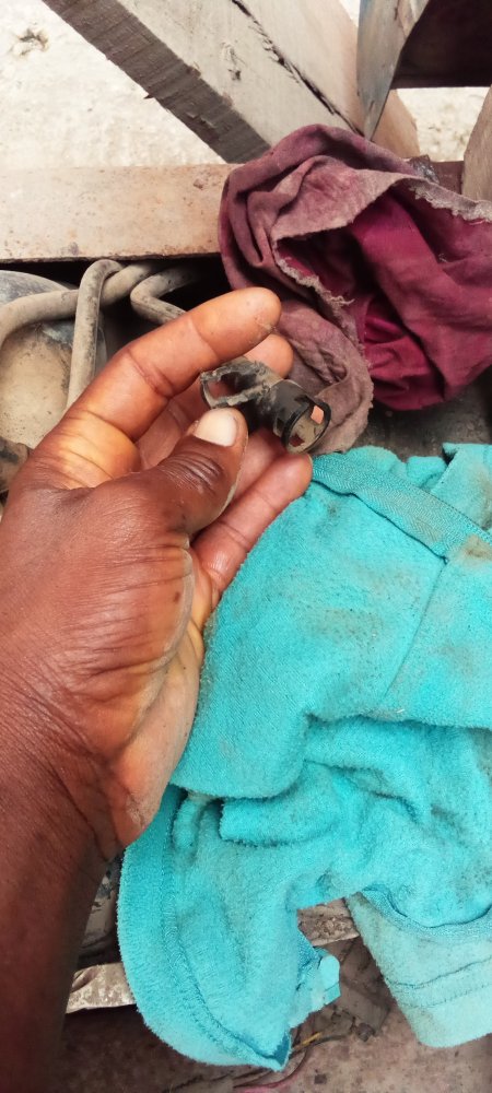

The problem i have now is how do i key in the plastic retainers holding the fuel hoses on the fuel pump back? One of the clips were broken, while the other was intact.
Is there a trick or tool used to remove remove or fix those retainers in place?
That's the plastic retainer clip I'm referring to. Is there a trick in how it should be installed?
