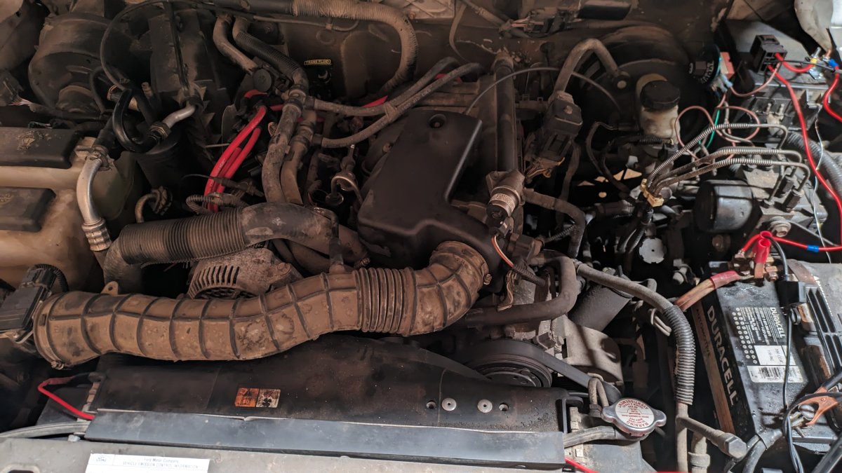

E-fan has been installed! Sorta...
Forgive appearances, things need to be routed, mounted (without double side tape), put into flexible looms e.t.c.

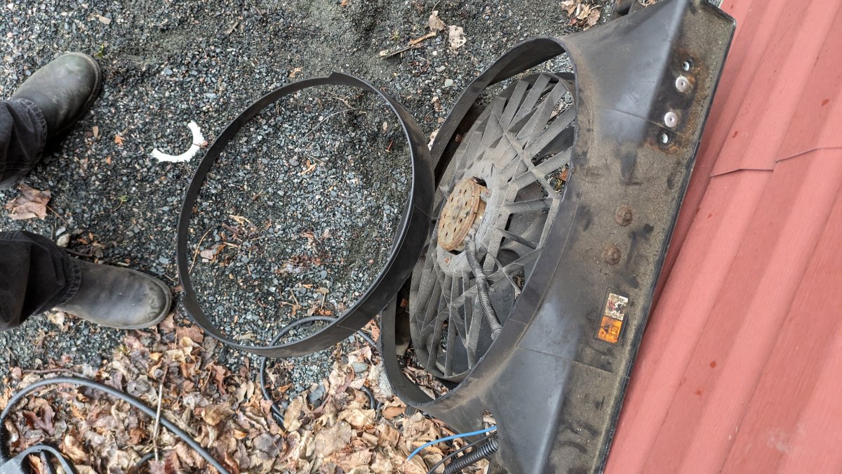

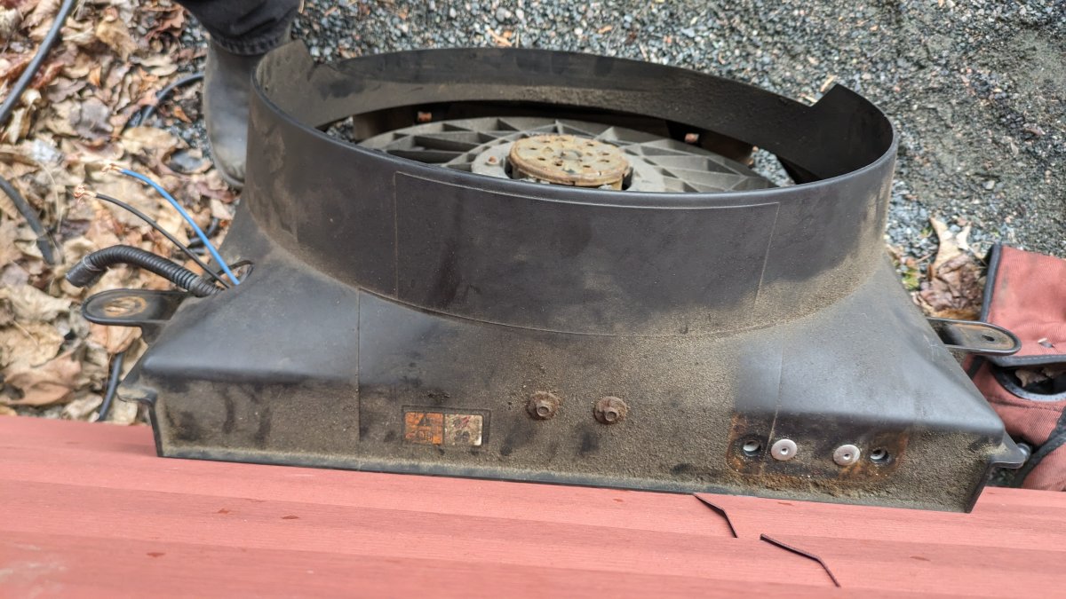

I've read quite a few posts about people using all kinds of different new, and salvaged fan units and shrouds in order to convert their Rangers, at the same time, I found out that 2.3 Rangers generally came with E-Fans, alongside clutch fans. Alongside those posts were folks claiming that these trucks were overcooled, and would get colder sitting at stop lights by noticeable amounts, and other folks would drive with only one or the other fan.
Since all 98+ Rangers (I'm pretty sure) have the same exact radiator, I figured I would just pull the shroud and fan unit from 2.3 ranger in the junkyard, and that oughta do the job! Sure enough, two bolts hold the shroud and e-fan in place, I was even able to salvage the unit without removing the donor's clutch fan with some shimmying.
The only modification necessary to put this on my 3.0 truck was to trim the shroud, since on the 2.3 trucks they encompass 2 fans, and extend further back considering engine is much shorter. I didn't do this super accurately, but I cut down approximately 80mm using my wheel of death, in the truck this thing JUST barely fits after modification, which is good, the longer the shroud extends back, WITHOUT touching any pulleys or belts the better, but you may want to trim some in order to more easily access the belts and pulleys. Here's a poorly shot before and after:

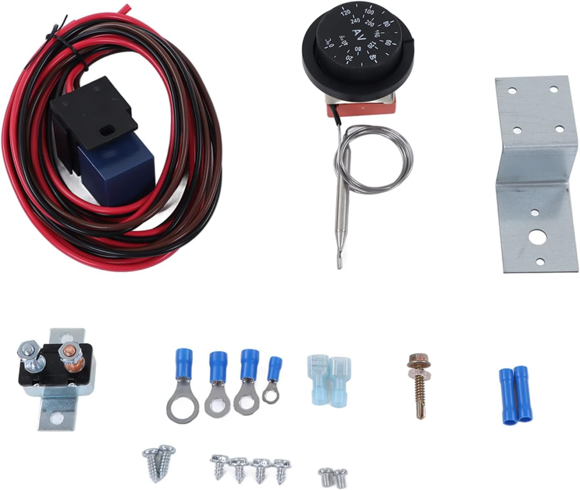

This is thermostat/relay kit I used.
I went for one of the thermostat/temp sending units with a probe and an adjustable thermostat for experimentation, and ease of installation given that I couldn't find a location to install a 3/8ths unit, nor wanted to buy a inline adapter. I don't know if I'd recommend most to use this unit given the added complexity, and the fact that the thermostat I received was slightly different in design from the one the instructions are for, and I'm pretty sure the dial unit shouldn't even be under the hood. I'm going to run it through to the interior, and create a place under the hood to securely mount things like relays and circuit breakers.

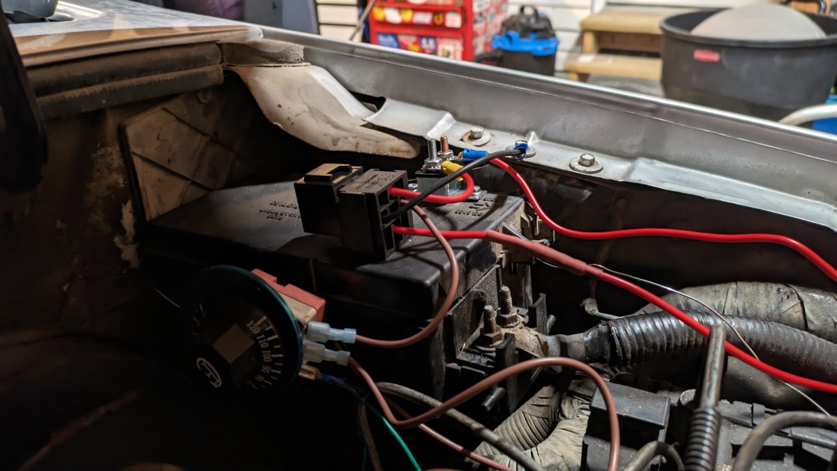

I wired it in by pulling getting ignition activated power via the fuel pump relay, I also connected the AC clutch relay so the fan comes on when the AC does, however, it is only on when the AC clutch is activated. For AC performance, this isn't ideal, for efficiency however, it's better than it running constantly when the AC is. Obviously the fans only turn on when the coolant gets up to temperature, the dial isn't very accurate, but I've been able to find tune it to allow for the highest safe operating temperature.
The temperature unit also allows you to close the circuit manually, so that the fans run always when the ignition is turned on, this could be useful in some applications, like towing, heavy grades with payload, since the transmission cooler is also mounted in front of the radiator.
Here's a bit clearer of a picture of the whole thing:
