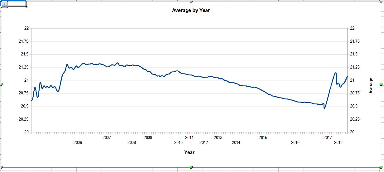

Thought I'd post my "from new" average graphed MPG numbers as an illustration of eFan change to MPG.
As you can see the new engine slowly gained MPGs as it was broken in. It then started a gradual decline for several years until I installed the eFan. You can see the sudden change. The engine is operating warmer than with the clutch fan, so I don't know how much, if any, the warmer operating temps contributed to the better MPGs.
Heat is a factor.
Put a brand new clutch and fan on it. Because age is as well.
