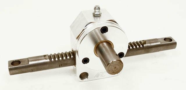

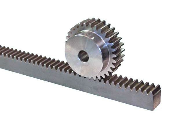

a gear & rack with a ratio and torque to turn the shaft. Essentially a small rack and pinion! The difference would be the rack moves gear. kind of reverse of steering in a car where the gear turns and the rack moves
