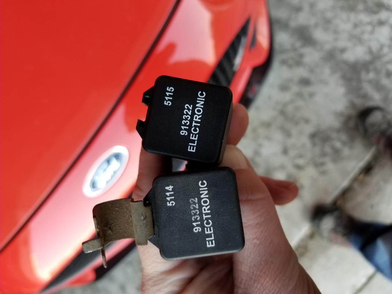

Alright, so I removed the connector for pin 1 and replaced it with a jumper directly to battery ground, still no voltage coming from the relay. Then I removed the connector for pin 2 and jumped directly to battery positive and still no voltage.
I removed the connector for pin 3 and I'm getting 0v from the relay. I have confirmed 12v is coming from pins 2 and 4 with ignition on with each test I have done. Pin 1 has 0 ohm resistance in all tests.
Am I getting bad relays...am I receiving the correct relays when I am ordering them? I'm looking at the ignition circuit now but if I'm getting 12v to the switched ignition circuit on the relay and its holding 12v, I have to assume that is working.
Attached picture of the 2 replacement relays I bought.

Take the relay out of the connector and use jumper wires to bench test it. You know how it works... power up the two positive inputs and ground the ground pin. Relay should click... voltmeter on the fourth pin should have 12V
Are you using a wiring diagram or just winging it? The relay has a diagram on the side of the internals. The eec relay is the same as the fuel pump relay there are four terminals two are the coil and the other two are the load. Do you have a good ground and battery voltage goin to the coil of the eec relay with the key on?

I bench tested both relays and both are bad; the solenoid does not pull the circuit closed when applying 12v across the switched power circuit.
I stuck the fuel pump relay in the EEC relay connector and I get 12v out of pin 3. So I'm either getting the wrong part for replacement relays or both are just bad. Not impossible, I suppose. I guess I just put too much faith in new replacement electrical components.
I might just take bobbywalter's suggestion.
Well, there ya go...
I had some 30A 5 pin relays sitting around from a project on my other car. I wired one up in place of the EEC relay and all is good.
