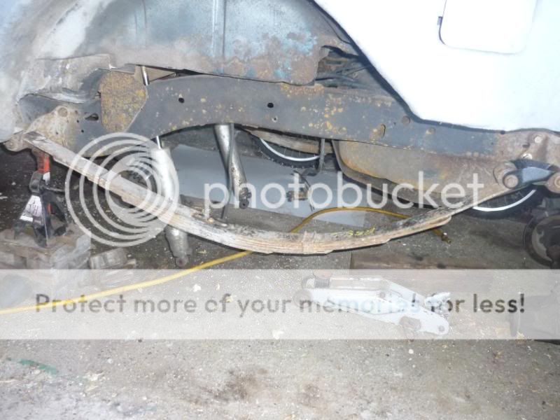

Finally got motivated to work on the truck.
Got the durango springs mounted and happy with the way they mocked up. Shackle angle looks good to me.
Now to get the new locked axle in place and see if I need to redrill the spring pads to center the axle. They look to be 1.5" forward from the explorer springs I had previous.
