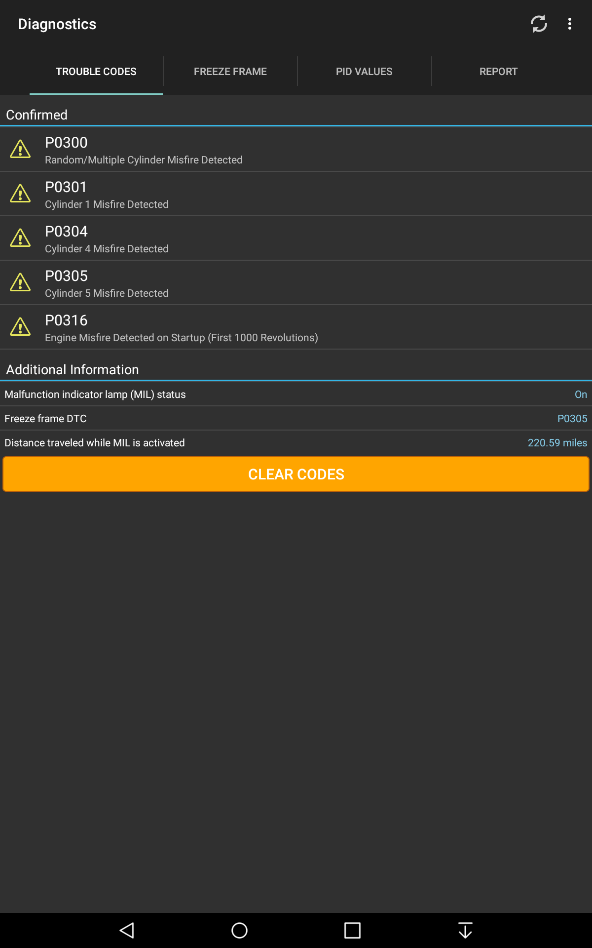

Update: Screen shot of error codes
I've attached a screen shot from OBDLink.
Replaced the coil pack and trunk run ok for a few days, but now it's started acting up again. Any help?
I no mechanic but its sounds like a timing issue. So my guess is to check your cmp closely. I'll link the page about it here.
