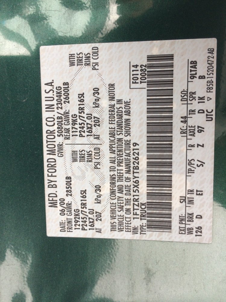

Door jamb sticker
GVWR is Gross Vehicle Weight Rating, Maximum weight allow for vehicle, passengers and cargo, if you pulled vehicle on to a scale its the max. weight that can be on the 4 tires
Remember rear of pickup can have 1,000 extra pounds added, 1/2 ton rating, so yes for GVWR rear can be heavier than front fully loaded in some models, but headlights are pointed at the sky, lol
No, they won't add up, Front and Rear are maximun AXLE weight ratings, you may have less weight on front but you shouldn't go above rear axle rating or visa versa
And the total of both axles can't exceed GVWR
And different models will have different GVWR, i.e. regular cab, supercab, long bed, 2WD and 4x4
Look up Curb weight of your model, say its 3,400lbs
GVWR is 4920, so 4920 - 3400 = 1,520lbs allowed for passengers and cargo
If Curb weight is 3,000 then 1,920lbs for passengers and cargo
So GVWR is good to know but need to know Curb weight as well for it to mean much
And Gross Axle Weight Rating(GAWR) also needs to be considered
And if you have a trailer then tongue weight needs to be added to rear axle(GAWR) and GVWR

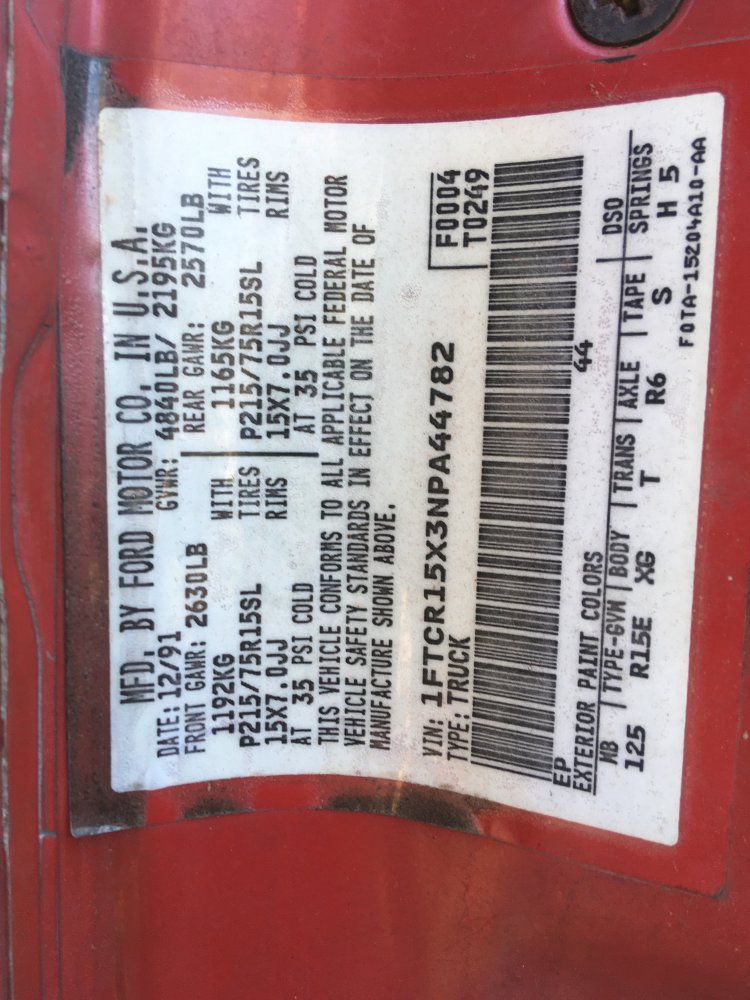

Note that accessory reserves are always small, a handful of pounds. Don't know how they arrive at it or what it is. One of the examples above has 4 lbs front reserve. What in the world?
It looks like if you add up front/rear axle numbers it's always (in these examples) 360 or 370 lbs less than the GVWR. That helps only a little...
One thing I haven't done is get the spring codes and see if I can find the capacity for those specific springs and see if it makes sense for axle max's.
