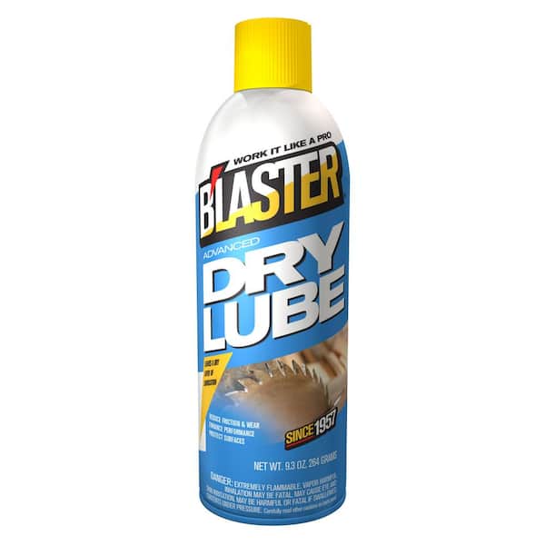

You're probably close to needing new hinge bushings. There are some dry lubes available that may work well. They spray on and the volatile liquid component carries a dry lubricant (such as graphite or teflon) into the places you need it. Then the liquid quickly evaporates. The dry lubes will not attract and hold dirt the way oils and greases do. Otherwise, I second the motion for white lithium grease.
