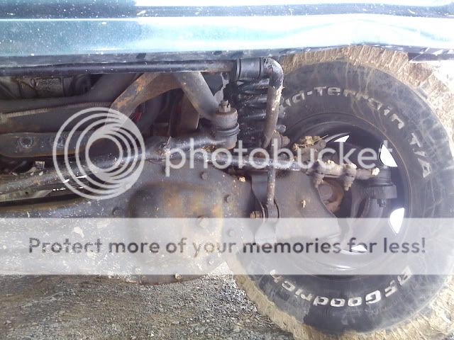

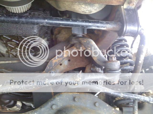

Here are pictures of the steering setup. I've IFS for so long but this all looks correct to me.

Hey are you going to do something about your front swaybar???
That thing is maxed out, does your front end have any flex??
I would try to lower the front swaybar mounts or take it off so you can get the front end to flex.

Chances are you have the FA400 arm already, from looking at the pics. The link that BeanMachine7000 posted explains the reasoning behind our madness. You want to keep your tierods as parallel to your beams as you can, and the FA400 simply doesn't do it when lifted above 4".
Also, steering stabilizers are a bandaid for improper steering. I drove my ranger for over 100,000km without one on 33's, 35's and 37's, and have driven many many lifted vehicles without them as well. All it takes is staying on top of wear items (or getting on top of them when buying a used rig!) and making sure everything is setup as well as it can be.

That's some pretty bad steering geometry. The tie rod should be completely horizontal/parallel to the axle beam. Do you have the FA600 pitman arm? It doesn't really look like it. If you don't, getting that would help. However, you may need to upgrade to a new steering set up, like the Stonecrusher steering.
Ooh... No wonder you have bumpsteer... This article explains it all very well...
http://www.therangerstation.com/Magazine/winter2008/steering_tech.htm
Yep yep, that'll be your problem.

I think what he was getting at is guys have done the same thing you just did and they ended up needing to get the FA600. Either they needed it to get the alignment right or needed more drop in the steering linkage, but what do I know:icon_confused:......I don't have a lift in mine yet
Ok, I was afraid of getting one that had too much droop. I'll have to check tomorrow to see if the order was placed yet or not.
