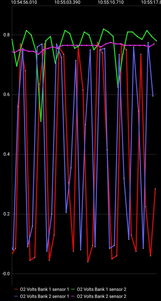

So, @RonD (or anyone else who knows). This thread started making me wonder about my 97 F150, 4.6l. Bought it used, now gas 150k miles and original O2 sensors. So I just went out to the driveway and started it up, let it warm up while I got the OBDII adapter plugged in and connected to my phone. Here is a screenshot of my O2 sensor voltages from the Torque pro app. If I understand your post, this shows that my cats are nearing end of life and one upstream sensor is getting flaky. Is that correct?
Personally, I wouldn't do anything based on just 1 test but that green line ("Bank 1 Sensor 2") looks somewhat suspicious to my eye. I'd run the test again, after you've driven the vehicle some miles. Even then, there are possibilities of being misled by looking at just one test. The "catalyst efficiency monitor" that I mentioned earlier in this thread could be running, disrupting the data you're analyzing. Or, if "rear fuel trim" is a real thing and at work on these vehicles, it could be causing misleading data. That's why I always recommend lots of testing. If you never see your downstream O2 sensors steadily reporting 0.7 to 0.8 volts, then you should start to be concerned, IMHO.
I don't see anything blatantly wrong with your "upstream" sensors (red and blue lines). They may be getting a little "lethargic", but it's hard to tell and Torque Pro runs on Android, which can cause uncontrollable perturbations in the output of fast-changing PIDs like upstream O2 sensor voltages. Of course, if they're as old as they seem to be, it's probably time for some new ones.
I'm interested in the answer too. The only thing I'd instinctively react to on that image is the Bank 2 downstream sensor holding a near flatline - makes me wonder if the sensor is aging and not switching properly.
The "downstream"/"S2" sensors monitor the catalytic converter output and are not supposed to be "switching". If you start seeing one do that constantly (versus doing it for short durations), over multiple tests, it probably means that your catalytic converter is losing effectiveness, causing the normal, constant, closed-loop, PCM-induced fuel mix alterations (that are quite visible in the "upstream"/"S1" sensors) to start showing up "downstream".

B1S2 is staying around 0.7v and 0.8v so looks fine, I can't say I understand the time frame, that's not 7 seconds in between samples?
Must be .07 seconds between samples, so pretty steady
The upstreams look OK, but could be a bit on the Lean side, so older
Average is about 3.75v which is good, but............there is nothing to compare it to if both O2s are the same age

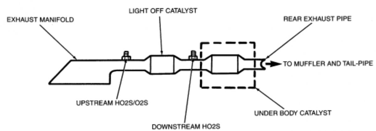

I've been doing a bit of research and I learned something new....
There is something called a "light-off" catalyst, which is "often used to minimize cold-start emissions". IIUC, the term "light-off" seems to refer to the temperature at which the catalyst is effectively converting the noxious gasses.
It seems that the 1997 Ford F-150 may indeed have come with 4 catalytic converters, 2 per bank, as Eric sees. If so, there would be 2 "light-off" catalysts upstream of the 2 "main" or "underbody" catalysts. Even though it doesn't apply to Eric's F150, to be complete, it seems that in some cases there can be just 1 "main"/"underbody" catalyst if the pipes are joined early (i.e. just after the 2 "light-off" catalysts). I suspect that's why the dashed outline is there in the image above.
So a 1997 F150 could very well have 4 cats! Interesting. And probably expensive. :eek:

My info says that the downstream O2 sensor "may be located after the light-off catalyst or underbody catalyst".

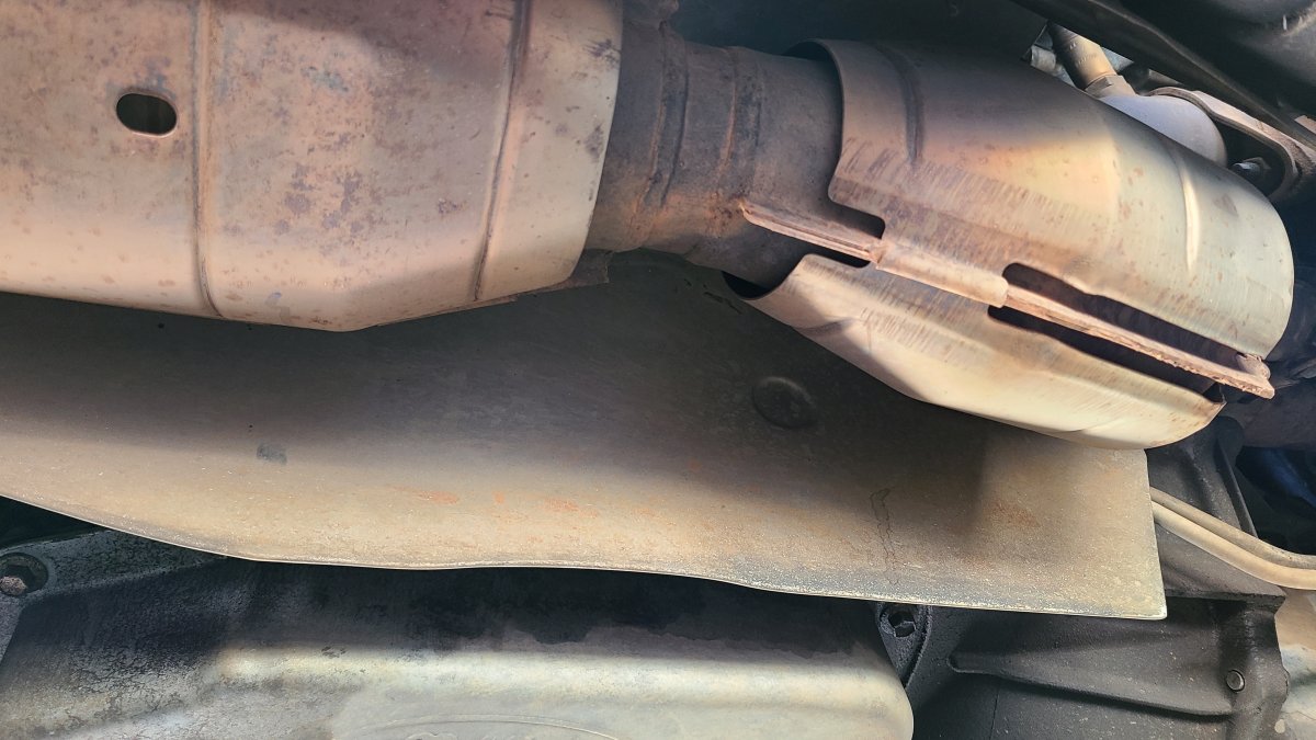

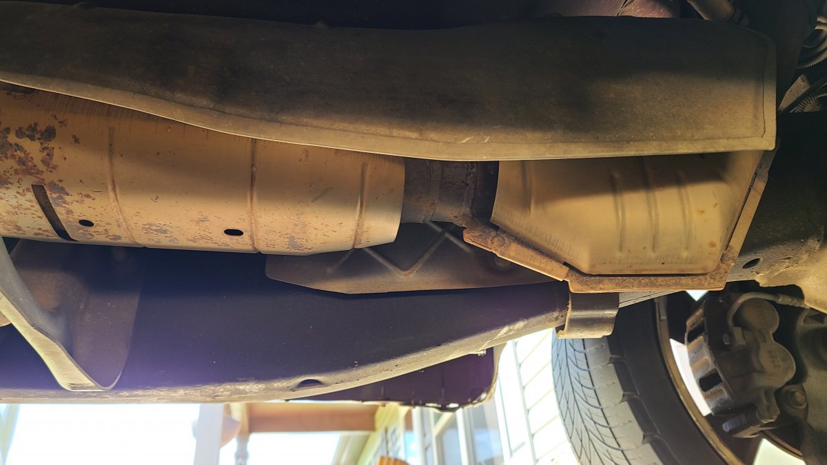

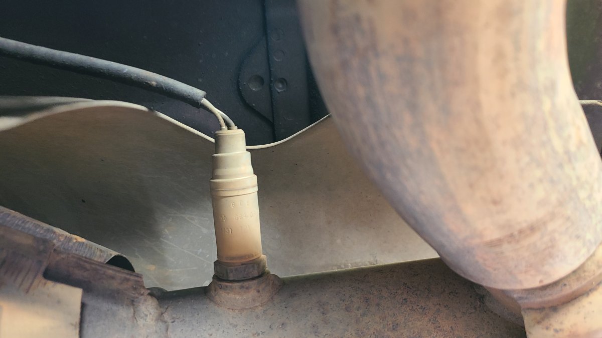

You're killing me, Smalls. My truck is lowered/leveled. These were not easy to get without jack stands or ramps.
Passenger side downstream sensor. Y junction to the right.
Driver side downstream sensor. Just before pipe turns toward the passenger side for the y junction.
2 passenger side devices.
2 driver side devices.

The graph does make B2S2 voltage look odd though, compared to B1S2
