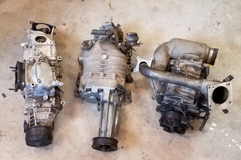

The mad max 2.9 looks like it has an sc12 or 14, he says its spinning in reverse so I have to assume an aisin.
Running vbelts and an auxiliary serp, probably some severe parasitic drain with that long belt and all those pullies.

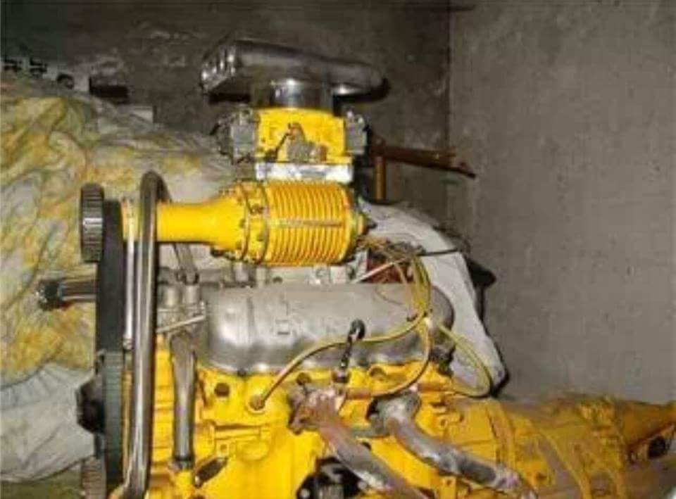

hey all, extremely interested in this. have a 2.8 in my pinto that i was thinking of the same thing. (have 2 extra motors to play with sitting on the shop floor) but was wondering about V belt driven centrifugal style supercharger. any information about this? i will read all these pages tonight that i see here. I don't want to be cutting the hood open to give away the secret sauce. ;)

Eaton M62. I have a build thread running on it. "really really bad forced induction idea"
thanks for the info, read over, don't think much will work for my idea. wanting to build blow though, keeping carb and non computer system. will keep reading maybe solution is out there.
