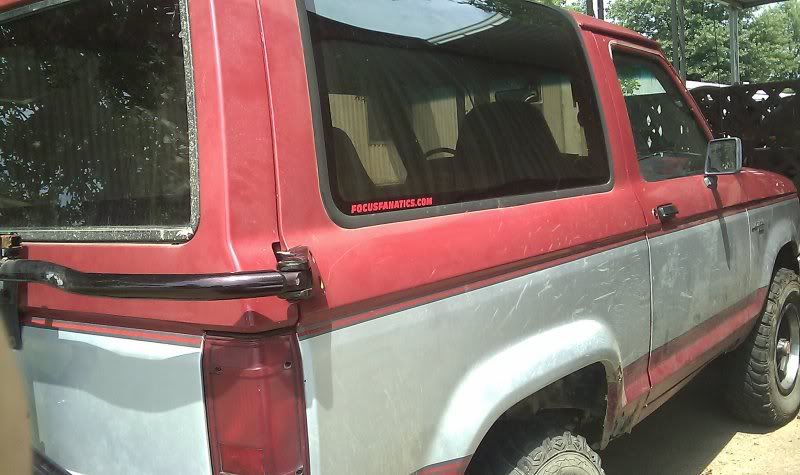

Yeah I am on both FJ and FF, but I hate FJ and I am hardly ever on there. In fact:
disciplerocks's Ford Focus "build" thread
Sporting FF in the B2 :icon_thumby: You over there Fango? Whats your SN?
