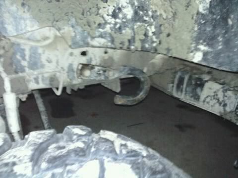

Tow hooks added for Interlake tomorrow :icon_thumby:

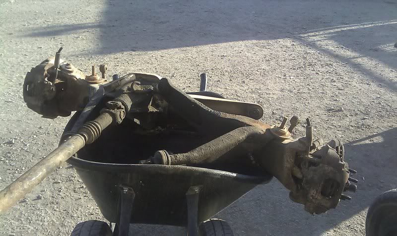

Had a lot of fun at Interlake today. At least until the damn Dana 28 decided to come apart. Cut my day short, but it left enough time to hit up the junkyard for a Dana 35 with 3.73 gears.
Lol yeah. Would have never gotten it out before they closed without Katie's help. Same truck had a locked 7.5 rear. Thinking about getting it if I don't find a 8.8 one.
Oh, idk. Tag said 3L73
do you have any pictures of your homemade brackets? id like to see them.
isnt that L in 3L73 for limited slip?
yea thats just a limited slip, wont do ya a whole lot of good in the dirt...
IMHO id go 8.8, the 7.5 just isnt worth putting any money into
make sure to double check the spindle nuts to see if they are for auto hubs....
and your D28 lock outs won't fit the D35....
