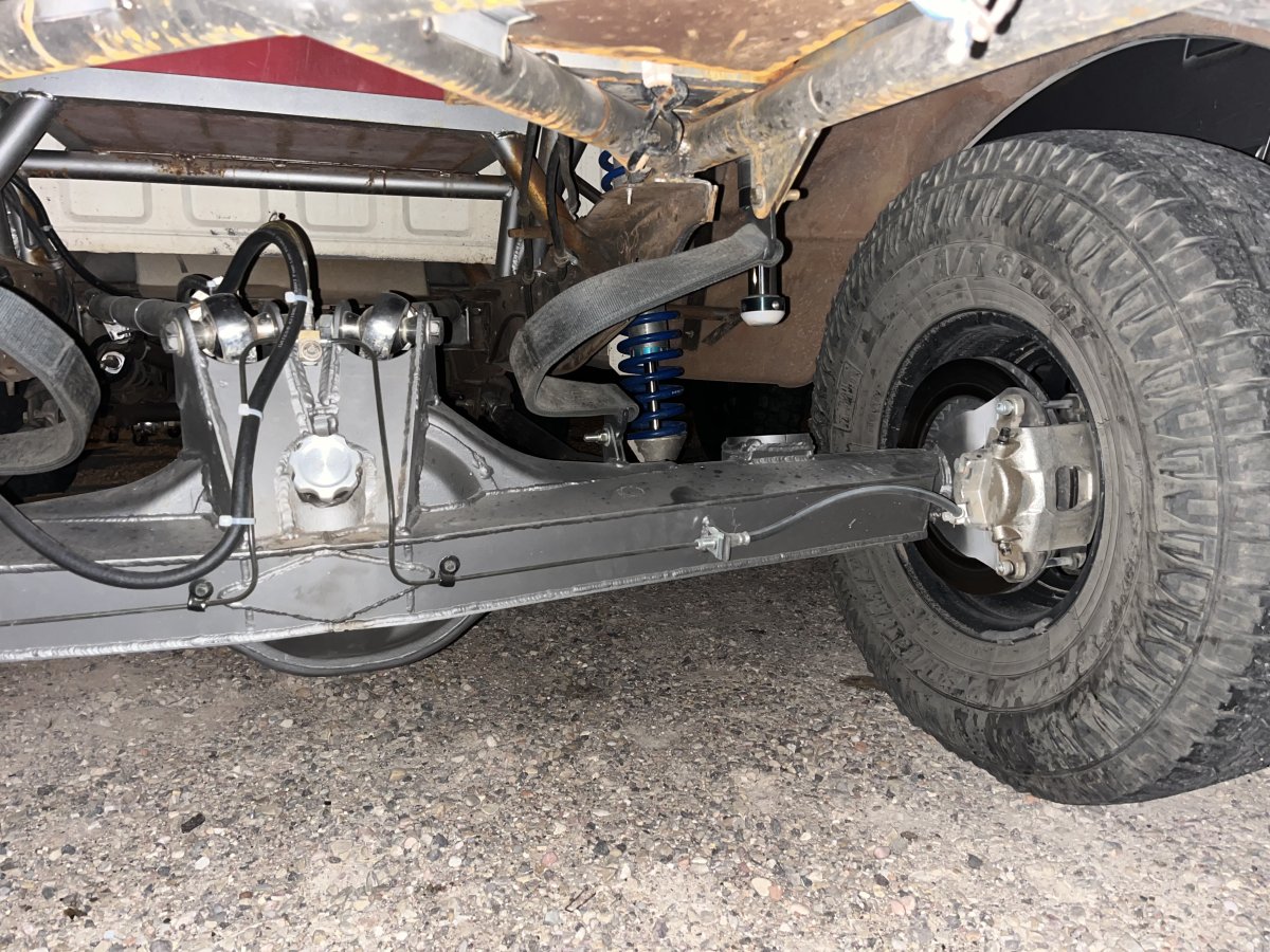

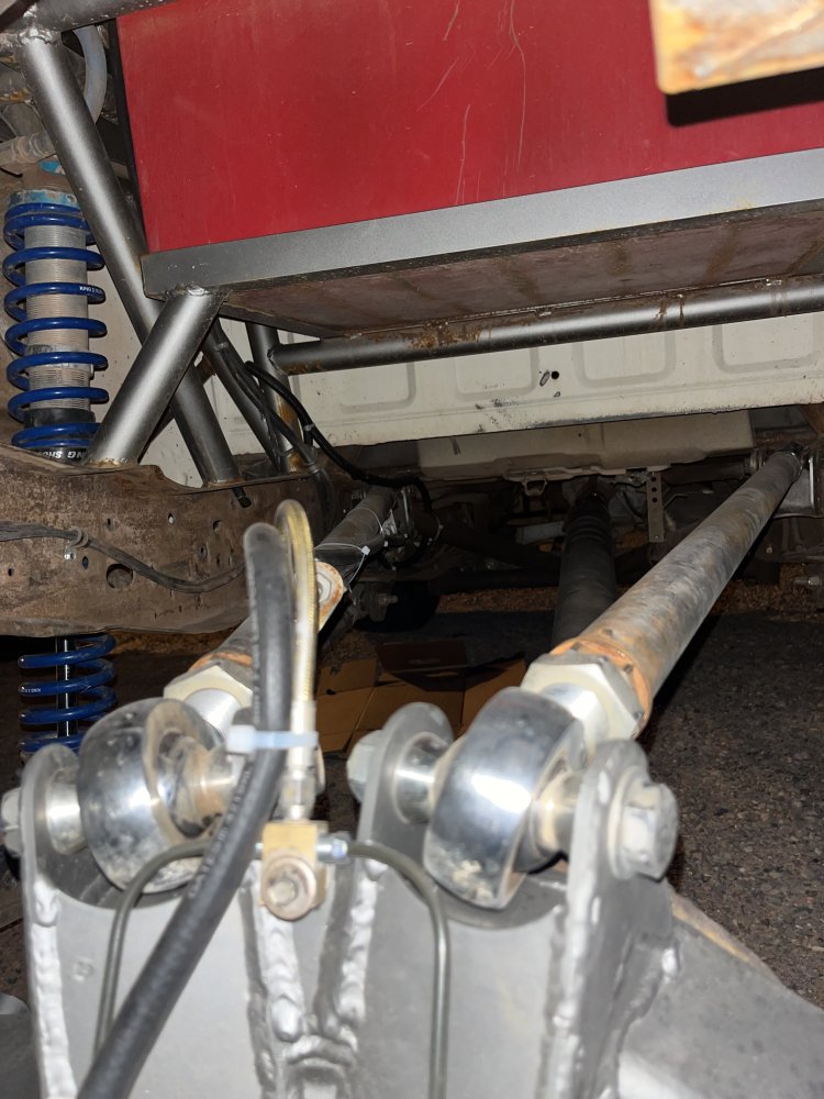

Re did all my brake lines today and here’s where I’m at.
New hardline from adjustable proportional valve to rear.
New front hardline from master to T fitting splitting directly to front tires.
Removed the factory proportional/shuttle valve.
Test drive it felt a lot better. Didn’t feel like I was missing half of my already dismally low hp. Pulled back into my driveway and I can manually roll the truck though it does feel slightly like it’s dragging. It may just be down to a slight misalignment on the caliper/rotor causing the minuscule drag I may be feeling at this point.
To clarify for future guys that may be reading this, I did not have a residual pressure valve in my master cylinder (85 ranger manual brakes). I did not see any sort of residual pressure valve in the factory proportional/shuttle valve on the frame rail. At this point the only thing that is different is the bypass of the factory proportional/shuttle valve. The pedal feels a little soft on the rear circuit which I believe is due to a lower volume output. I will put some miles on it and if it feels alright I will leave it be, if it leaves me wanting more I will look around for another MC to run and report back if I remember to.
