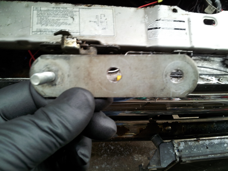

I did get the radiator problem fixed, thx to my son. Guess I just needed a new set of eyes. What I did was just move the radiator to the left about 1 1/2" and it cleared the alt just fine. I got these brackets to facilitate the move.

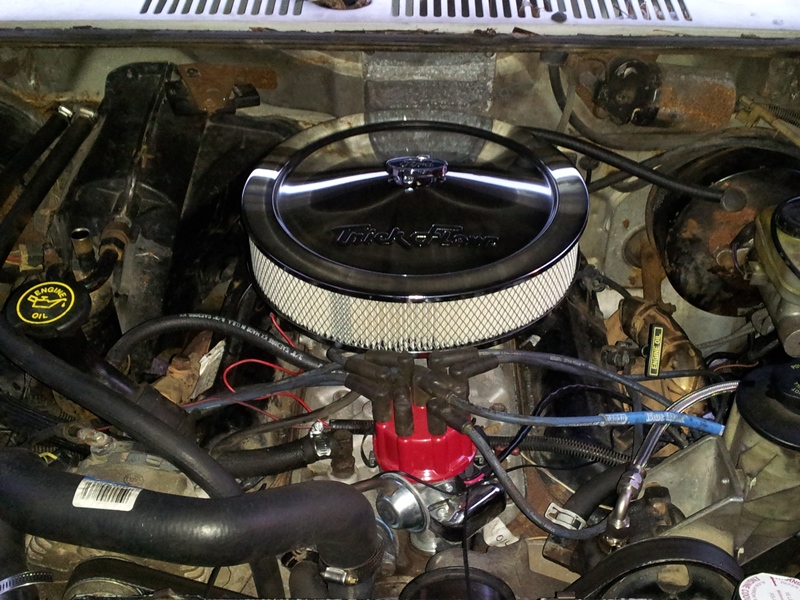

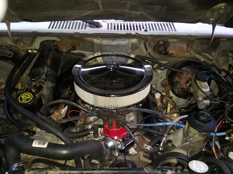

Here is the engine as it sits right now. Ill post more pics when I get back from the muffler shop tomorrow, getting a complete exhaust as it sounds like a tank right now.
