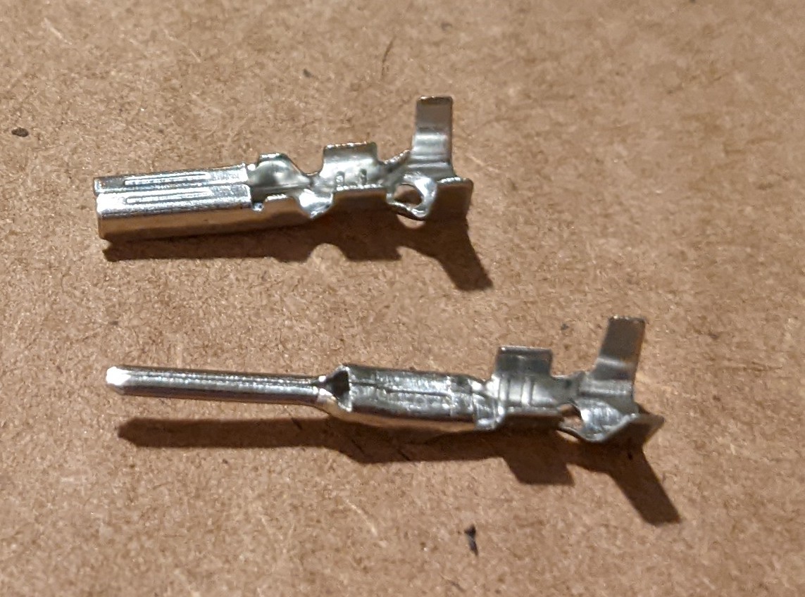

There has to be a tab that locks it into the connector body. That little tab has to be pushed down to release it from the body.
Look at the terminals that haven't been inserted into the body to see it. Most times a flat connector pick or a tube type pick slid in the front face of the connector body will release the tab.
There's definitely a tab that locks in on the terminals as you insert them to the back of the connector shell. I'll look again this evening with some of the extras in the kit. I did that the other day and still couldn't get them to release, but I found a couple of photos of using the official Metri-Pack tools on those connectors, which are very similar. Hopefully there's a simple way.
There's enough extra on the cable that I could just cut off one side of the connector and remake it, but I wouldn't learn anything that way.
When you find that spot they come right apart. It's sometimes requires a bit of a push inward on the wire... release the tab and then pull the wire. If that makes sense.
It definitely makes sense. I've done it plenty of times on other connectors. This particular variety is just giving me fits.

Those look like Metri Pack 280s… are they tangless or do they have tangs?
By that I mean are there metal tangs that stick out that lock them in or is it a plastic tang on the body that holds the metal in place?
If they’re tangless, you need to push the plastic clip away from the metal insert. If they are tanged, you have to push a tiny screwdriver in and bend the metal tang to release it. (Then you bend the tang back out to reuse it.)
Tangless:
Depinning generic waterproof electrical connectors?
Tanged:

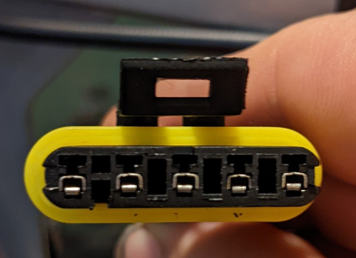

As shown in your third picture, take a T pin or something thin and pointy, put it against the top of the terminal and push back until you get to the catch on the connector then pry it away from the terminal and you should be able to pull the wire out the back.
