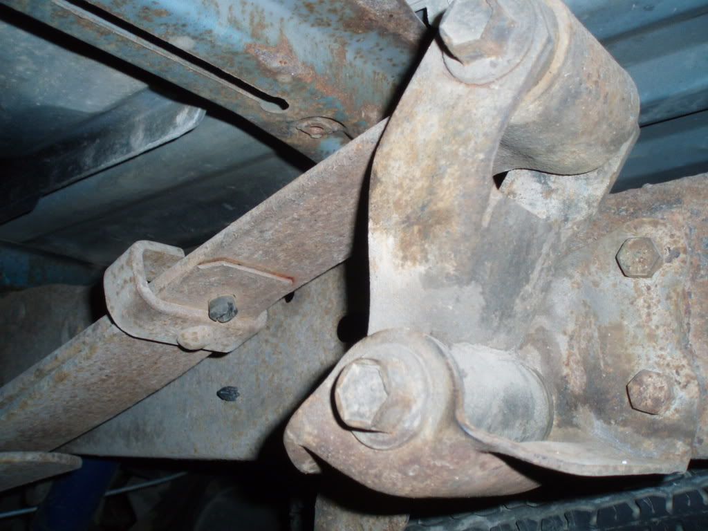

Pic of what the shackle will look like once you flip it. This moved the leaf spring UP about 1 1/2" to 2" which moves the truck down.
(I didn't measure anything before I did it. I was already lowered. Sorry.)

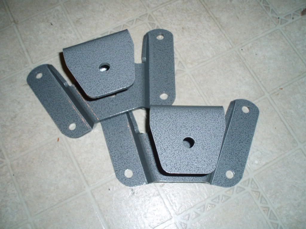

Here's another thing you could do. I'm going to be doing this as soon as I get a guaranteed free day on the weekend.
DROPPED FRONT HANGAR!!! $110 shipped. I'll get you the site if anyone wants it.
They look even better in person. Nice, heavy, thick, QUALITY that's made in America (as in, OUR-merica) Company was even nice enough to include all the grade 8 bolts and nylock nuts and washers needed.

The front hangars I have are said to give a 2" drop from factory. I do not know how much it will drop it COMBINED with the shackle flip in the back. I have yet to install them and find out.
