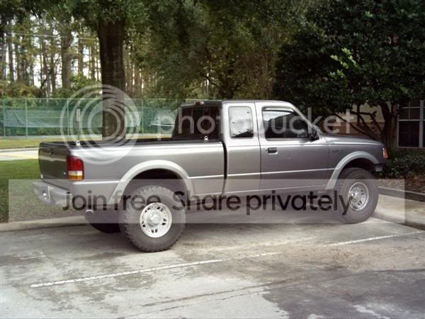

Day one pic of your Ranger and current pic
How it looked then:

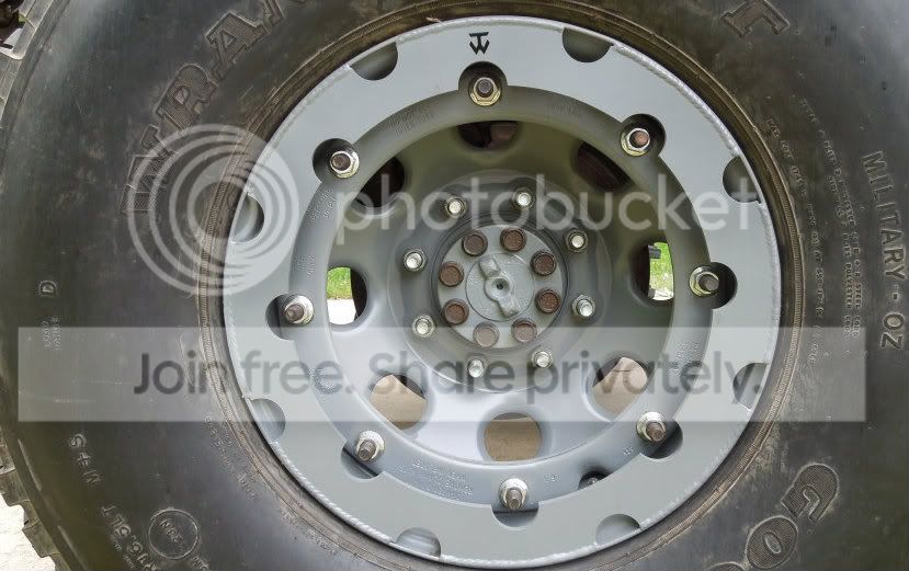

What bead locks are those? They're awesome! And nice truck I've always liked it.
Thanks, They are 8 bolt double beadlock H1 (humvee) military take off wheels, recentered to 3.5" backspacing with PVC inserts instead of the magnesium or rubber runflat, and TrailWorthyFab 1/2rock rings welded onto the outer rim for strength.:icon_thumby:
