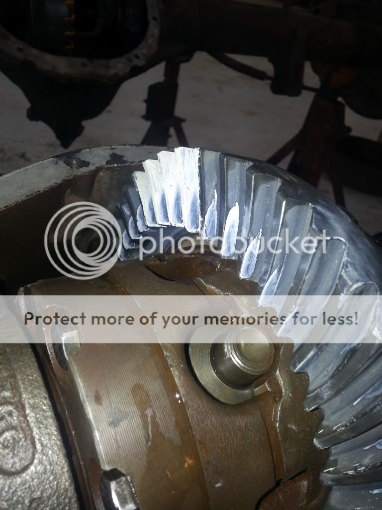

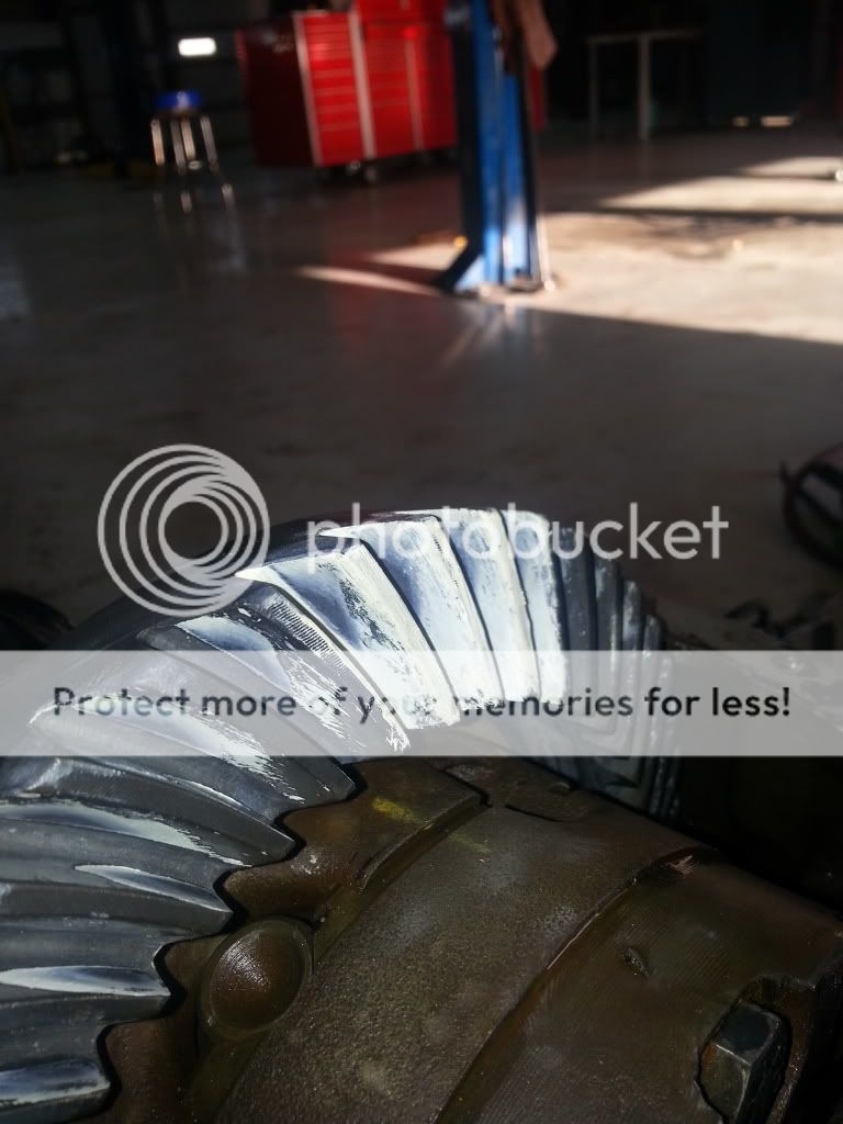

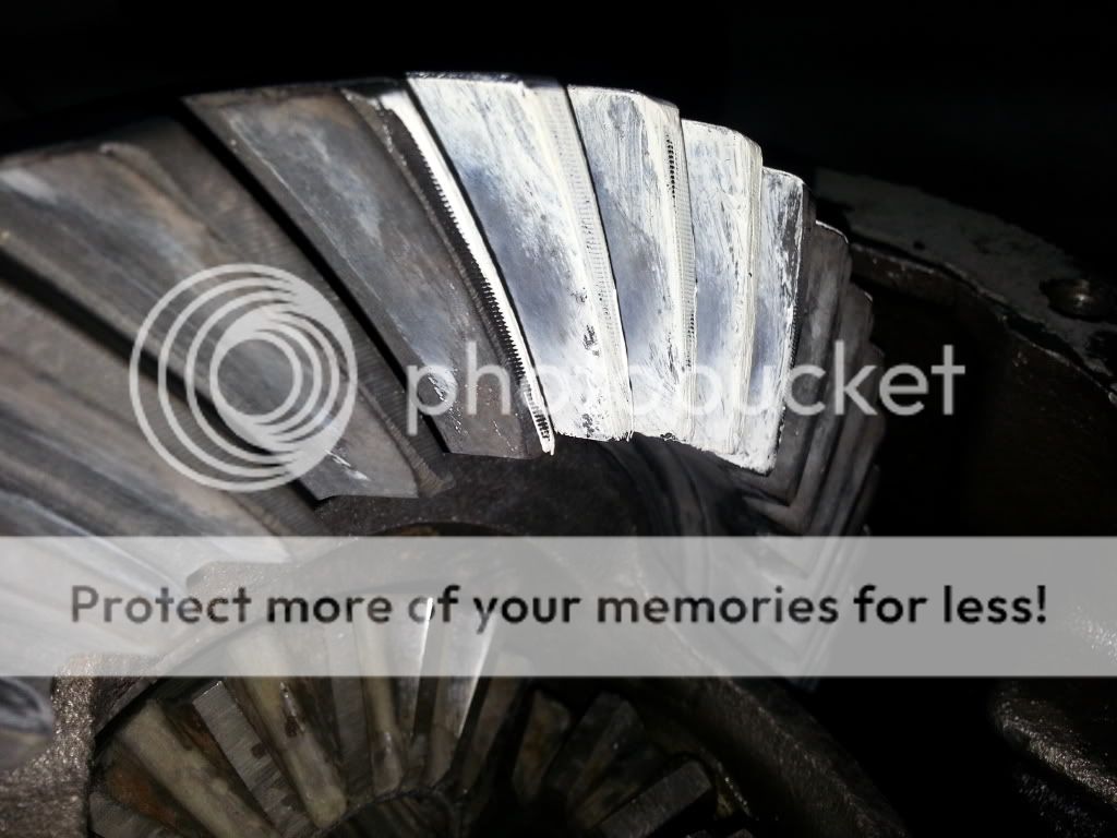

Trying to get some opinions on the pattern of my Dana 44. Its A High Pinion If that matters. 4.88 gears. I think my pinion is too deep but I'd like some opinions. Backlash is .006"

Yup... Pinion needs pulled back.

How far off does it look. Like .005" change or more?
I'd start with pulling .005, if nothing else it'll give an idea of how much more it needs to go.
You did set it up with only the oil slinger behind the inner pinion bearing, and the shims under the inner race in the housing, right?
The opposite way is the old-school way, way more of a PITA, and the wrong way according to current Dana, Ford, and Mopar service bulletins.

Pinion is too deep and it also looks like the backlash is too tight. Your pattern should be centered on the gear teeth
Yes, but don't touch the side shims till the pinion depth is set. Pulling the pinion back will move the pattern out and increase backlash.

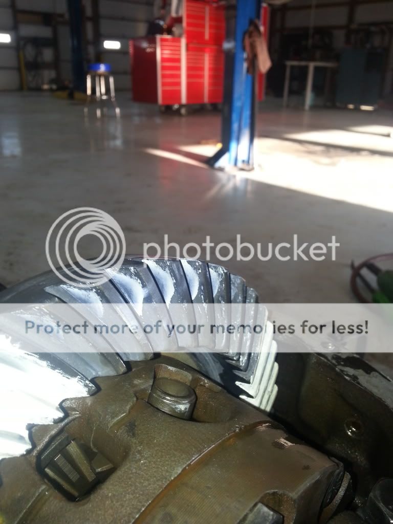

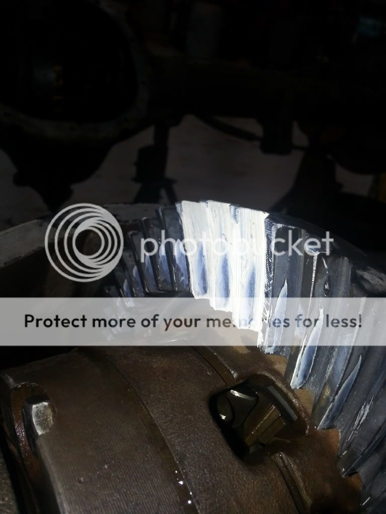

Haven't had time til today to mess with it again. The backlash is a little tight cuz I didn't have enough shims. I'll get some more and get it right but I ran a pattern anyway. What about this pattern?
