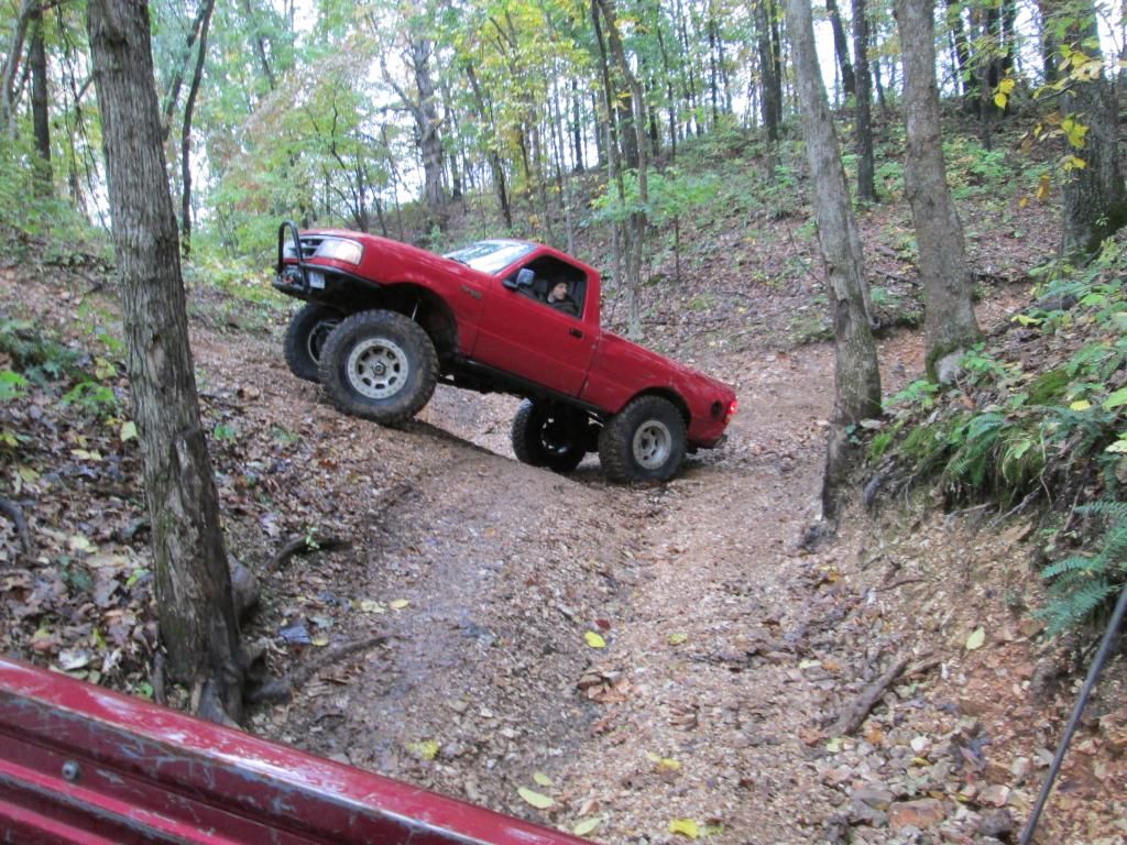

I made a return trip down to SMORR this past weekend to meet up with Kage and company. It was a wet weekend full of hardship, haha.

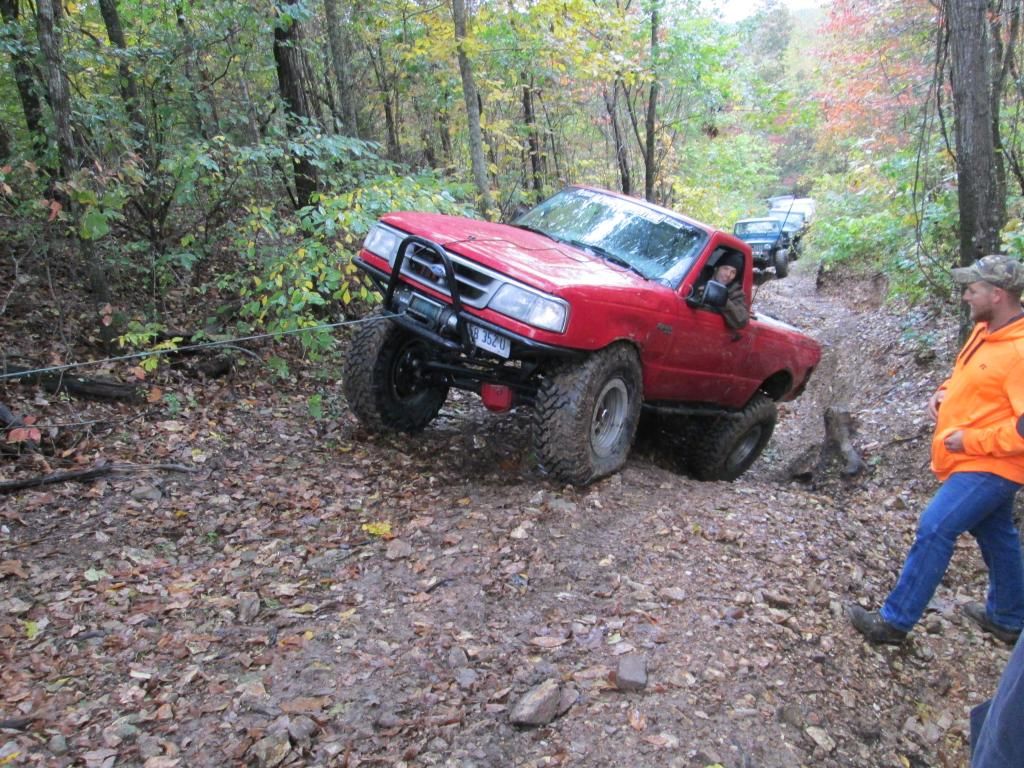

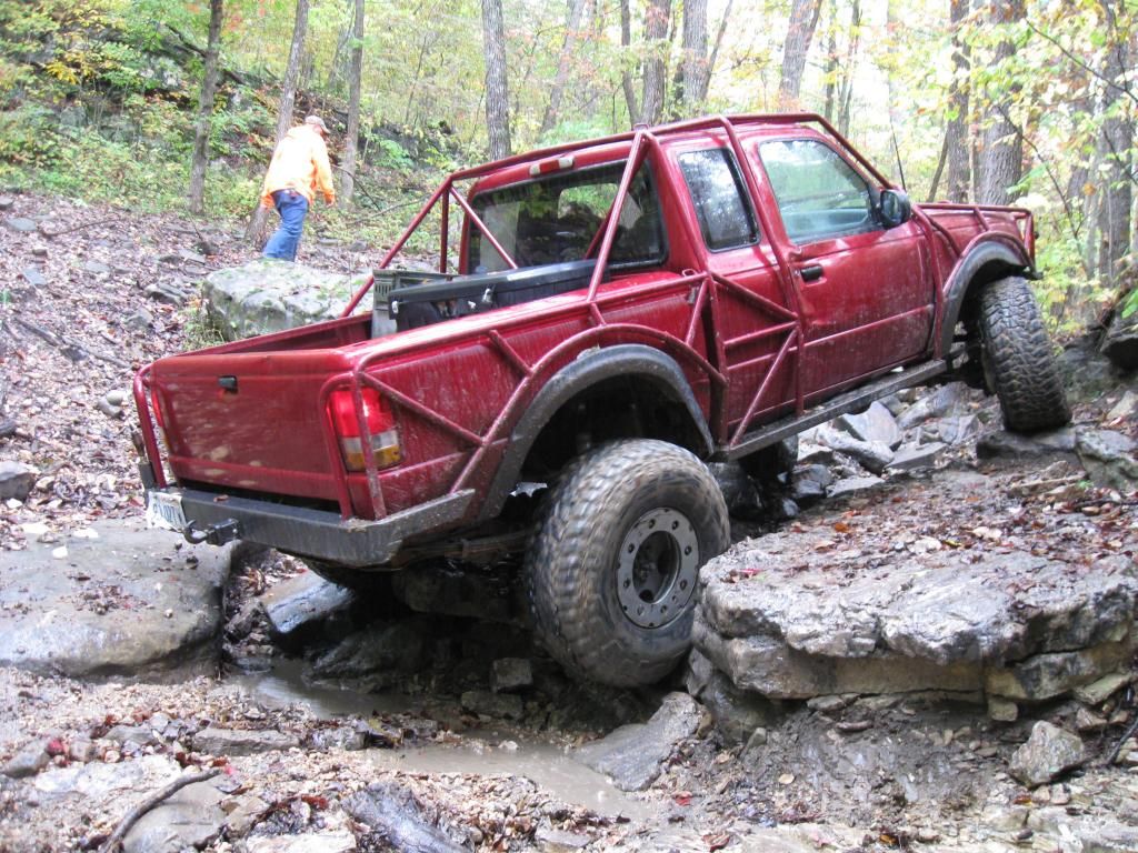

Since rain was forecasted for the entire weekend, I decided to rock the full doors. It changes the wheeling experience entirely. Far more constrained and 'blind' to the obstacles you're climbing. It was nice being dry though.

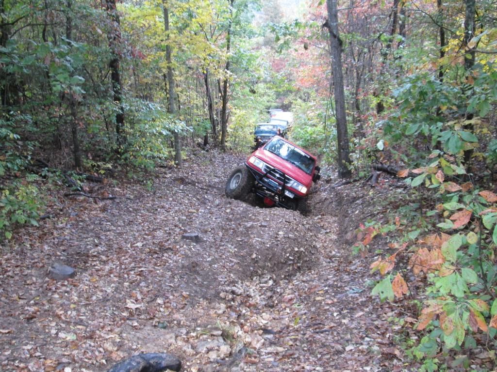

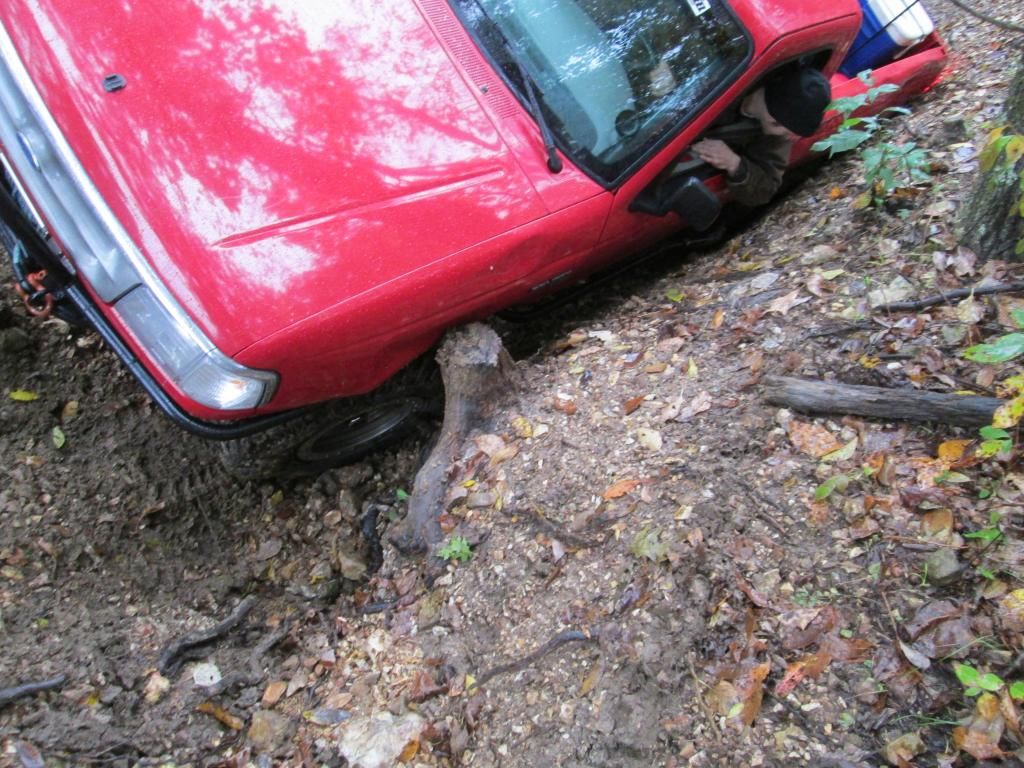

We had a pretty good day of wheeling, up until around 2:30p. We were running a creek trail and I found a hole that swallowed my truck up, unexpectedly. Hydrolocked the engine.
After pulling the plugs, I tried to turn the engine over to purge the cylinders. The starter just clicked. Tried running jumper cables to my battery; didn't work. We ended up pulling the truck to purge the cylinders, reinstalling the plugs, then pull starting it. Luckily there wasn't any engine damage. Ran like a champ.

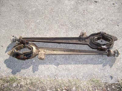

I wrapped up my snow plow build as well. It's a heavy bastard, but should work well for clearing our lane this winter. Started as an old Western Unimount.
Thumbs up. Even more function added
I love that thus truck is so versatile. Makes me laugh when people say rangers arnt "trucks" because you cant work them
Thanks guys. I think it'll work pretty well. I'm still anxious to see how much snow it'll truly push, but I guarantee it'll push more than I could with a hand shovel, haha.
Could you have used the D44 radius arm caps that have provisions for sway bar?
Look again, that's exactly what I have, haha. I notched the 'rib' and recessed my 3/4" tabs up into the cap then fully welded.
Didn't want to use those tabs though, as they're not perpendicular to the axle tube. They're parallel with the RA, which angles toward the center of the rig.
You could use them, but the tab on the cap wouldn't be parallel with the tabs on the plow frame.
