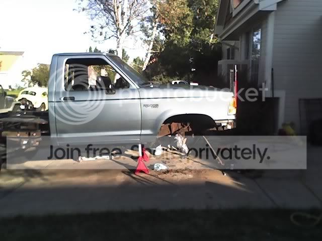

Hack that frame off after the spring hanger and weld that box tube inbetween the frame rails for added support to the lowered spring hangers. No point in having more overhang than needed, especially if you are attempting to build a truggy.
not sure yet how to handle the rear.i want some room to play with for moving stuff around for weight distribution.the length can give more leverage for dealing with the rear if it is in fact too light,and it is as it sits.and the front spring mounts are right at the bottom of a crossmember,so no sweat there,and the rear 'member is gone,but my bumper is plenty stiff to keep the back from wobbling the rails and causing havoc.once i get the bed and weight distribution settled i will whack off any extra frame rails sticking out into space.and that thing in the front is to lift the front with for now,it will go away and be replaced by something more appropriate as a crossmember.
truck frames are like silly putty when you leave the bed off,i need to get something to bolt down and stiffen it back like stock somewhat.

If I were you I'd bob the bed.

its kinda hard to bob the bed when we tossed it in the trash
Interesting ideas, lowering the spring hangers. I have to wonder how well that will hold up. As I am reviving my old Ranger, it will be seeing some tough trails here in Utah. More lift, and getting rid of blocks are on my list. Even considering coils and 4 link in back. But the add-a-leaf and stack blocks just won't cut it.
Oh, that 12" you state at the back bumper will be off some, as you haven't done anything to the front yet...

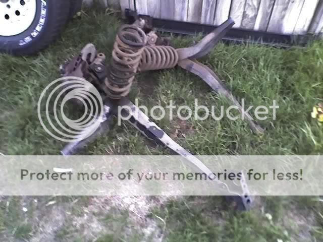

a bit more work
got the rear diff DIY kit from blue torch fab all welded and ground,and installed.the bolts were wrong that were shipped with it,and the stock ones too short.so i gotta get more bolts,but no real big efff'n deal tho.LOL
also trimmed the rear of the frame back 6 inches,and capped off the rear bumper too.still waiting for some suspension doo dads before we can scrap the front suspension.i dont want a dead car in the driveway if i can avoid it.

i thought about lowering the hangers,and then saw it done that way from the factory on a chevy 3/4 ton truck.and my angle is a tad thicker than the truck frame,and all are held in place with 1/2 inch bolts.the bed is all wobbly like a farkin' wet noodle,i need to get some kind of box on that to stiffen it up.

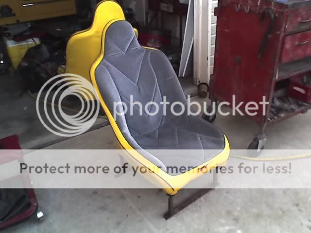

I built this for my truggy project.

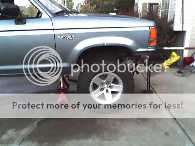

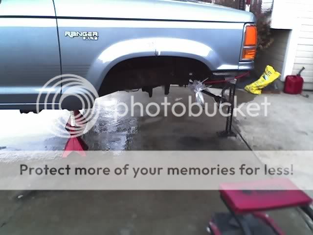

WE ARE GETTING THERE.........under there and not yet mounted.will do that saturday and see how it goes.
damn i am glad to get to this point,been a while in getting here.:icon_welder:

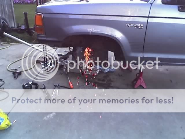

heres the pics i got today as we were working
