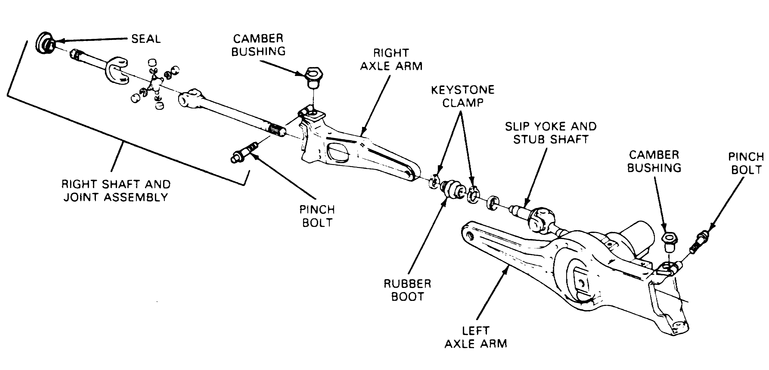

On the front axleshaft where it is splined and the the shaft that goes to the PS slides into the one coming out of the differential there is a boot, anyone know where to get said boot or what the part # is?
Also anyone know if someone is still making splash shields for the brakes?
The boot in the center with keystone clamps on each end.

Dana 40929 BTW :D
http://www.therangerstation.com/tech_library/pdf_documents/Dana_Ford_35.pdf
Pricey bugger...
http://www.napaonline.com/Catalog/C...Dust-Boot-Spicer-Dana/_/R-TWR40929_0180349381
I always just used an aftermarket shock boot and two zip ties to replace it. With the C-clip eliminator spring the stock boot wouldn't fit anyway.
I gave up on driveshaft slip yoke boots years ago...they just get torn off in a few minutes in the rocks.lol I just lube them up good every trip.
The only rock I run on is the crushed limestone they cover the roads with and it produces copious amounts of dust. I would like to have a boot, the c-clip eliminator in the tech library shows the boot staying.
I see it is the same as a D28 so that is a work around if mine has much life left in it.
I used a large spring on the OD of the shaft and there was no way to get the boot back over it. If you used an internal spring the boot should work just fine.
Yeah I have an external spring with the boot over it on mine also. It's sort of a tight fit, but very doable.
The D28 boot is much smaller than the D35/D44 boot.
I would think so but the places that have the D35 one also list it fitting a D28 and even a D50. :icon_confused:
