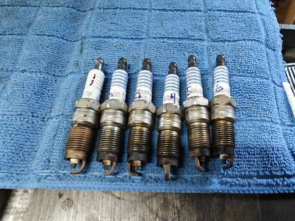

I found the picture from when I changed my plugs. The far left came from cylinder 4 (I just numbered them in the order that I took them out). It is an AutoLight where the rest were Motorcraft.
Cylinder 4 is drivers side all the way towards the front of the truck right?
Is 4 longer or just the angle of the shot?
The first one definitely doesn't have as much carbon build up. Likely not firing unless it was changed later. Considering it's a different brand, quite possible.
Not sure as I tossed em last summer. In the for sale ad, the previous owner said he had just had plugs and wires done but I highly doubt that. Unless a shop told him they did. My guess is he had the same random cyl. 4 misfire and just replaced that plug to try and cure it.

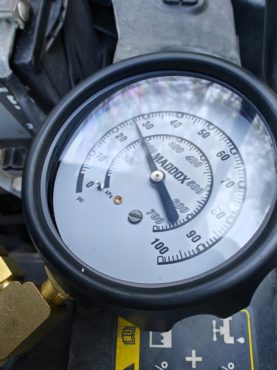

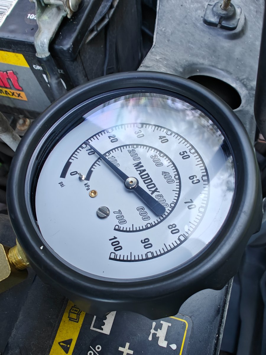

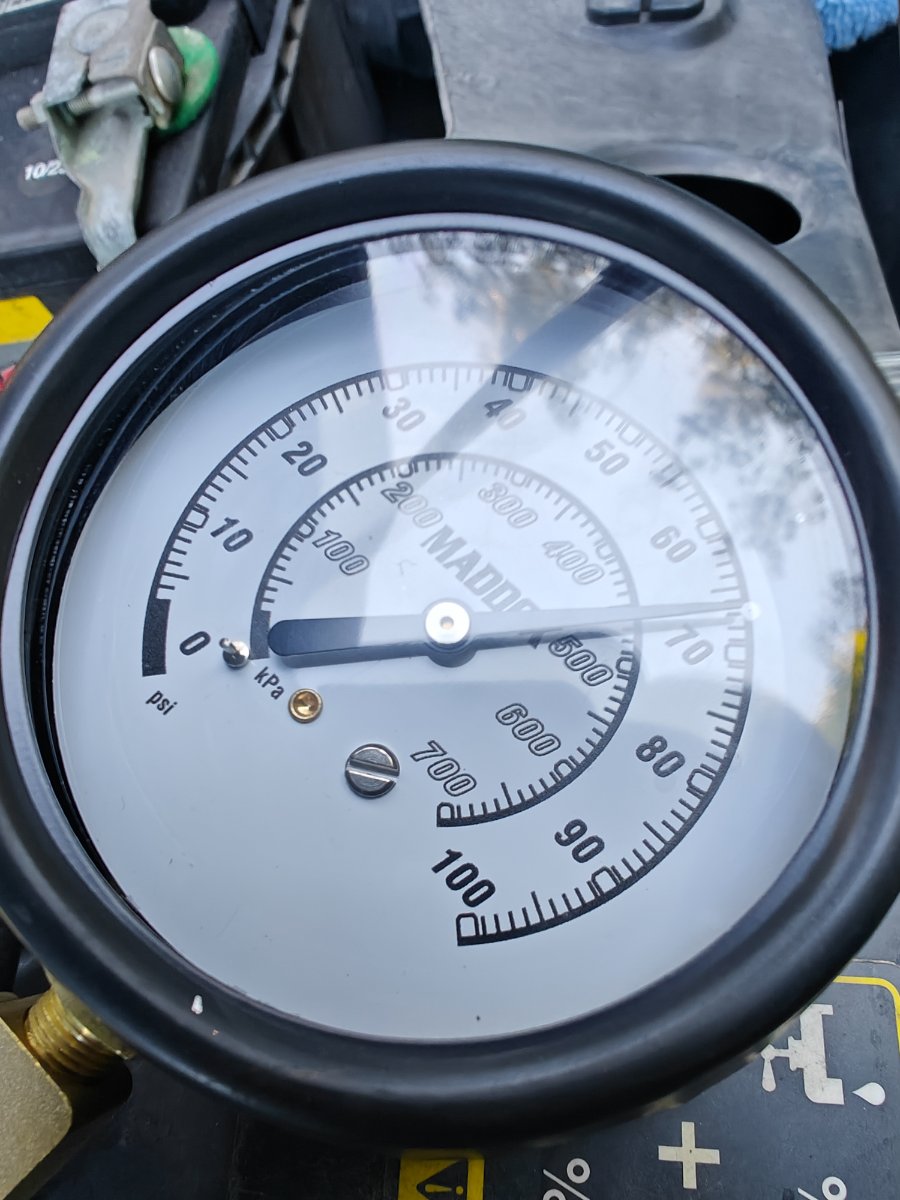

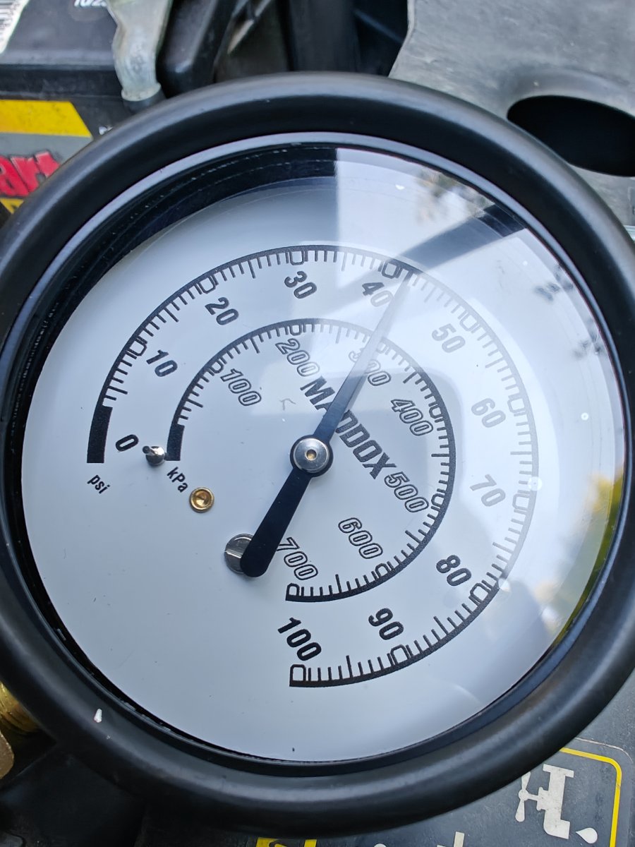

Spent the afternoon going to HF and buying a fuel pressure tester.
Turns out I have no pressure-low pressure (it varies) when I turn the key on but 65psi with the truck running. I guess fuel pump?
If I keep turning the key to the off and then on again position the fuel pressure rises about 10psi each time.
