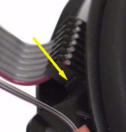

Are you talking about the plugs on the ends of the ribbon wire?
There should be small tabs at the base of the plug on either side. This image is from a cruise button on Amazon. not sure which one you chose, but the ones in your steering wheel should be similar.
Cruise Control Switch Replacement
Ok thanks that helps in all the videos I watched I only saw one person mention tabs everyone else appeared to be just grabbing the plug with their needle nose and pulling it out.
