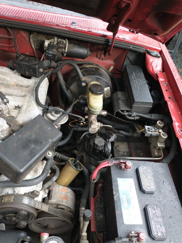

99% of '00 Rangers are prewired for cruise. You can tell is yours is if it has the cruise module connector on the passengers fender well - I'll take some pictures tomorrow (dark already here).

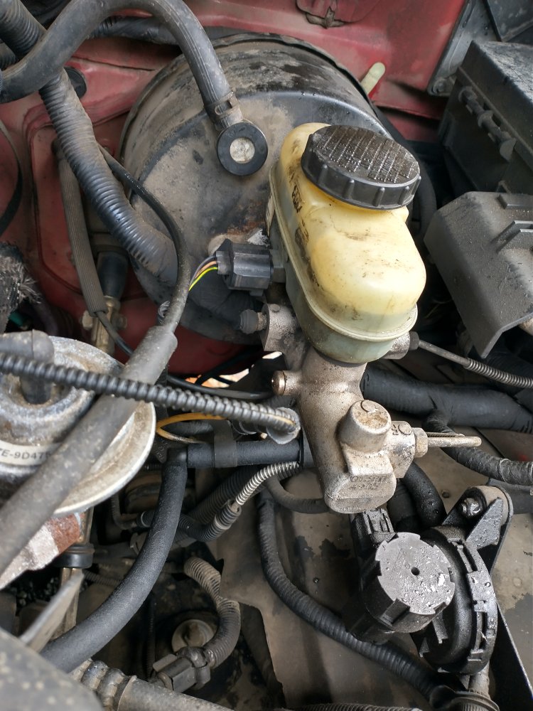

Thanks for the pictures! Item 1.1 is not on the right fender and the orange switch on the master brake cylinder is not there. There does seem to be a sensor below the reservoir in the middle of the cylinder, maybe same function?

The sensor below the reservoir is the differential pressure switch - it comes on in case of brake failure - e.g. burst line (well, in theory, if failure is imminent).

If you don't have the connector 1.1 on the passenger fender well, your would be on of the 1% not pre-wired for cruise (1% is still over 3,000 trucks). And its much bigger exercise to add.
And you need the master cylinder with the hole tapped for the cruise disable when brakes applied sensor.

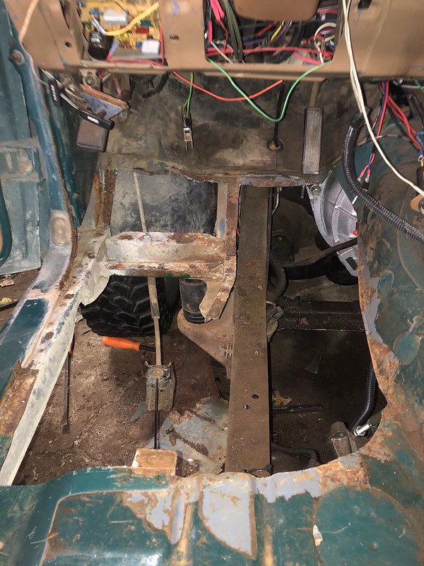

Here is mine, just left of the accelerator pedal with the big grommet.
Cruise Control kit, where can I get one?
Guess I should crawl under and look up! Hey, did anyone tell you there's a hole in your floor? Thanks

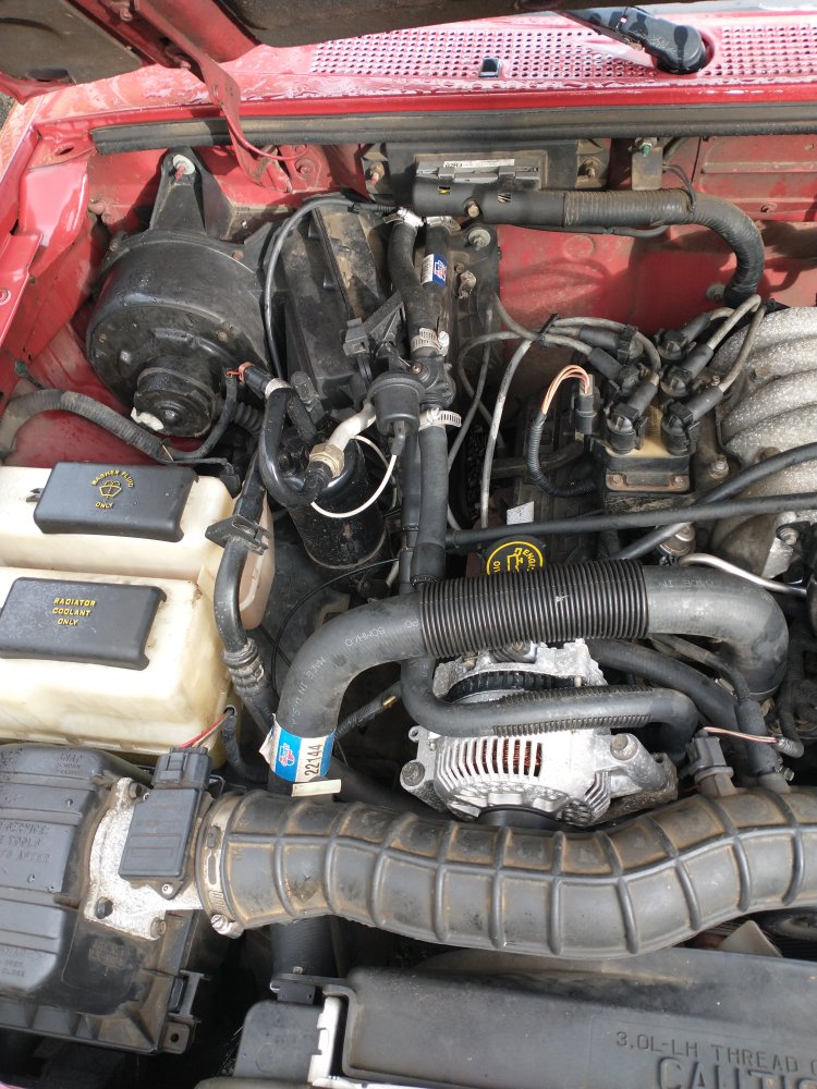

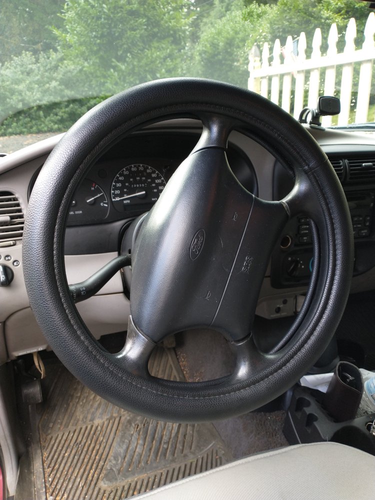

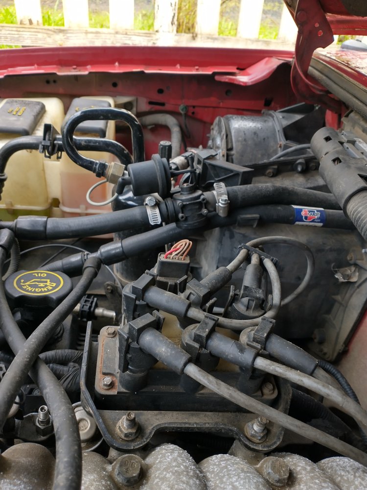

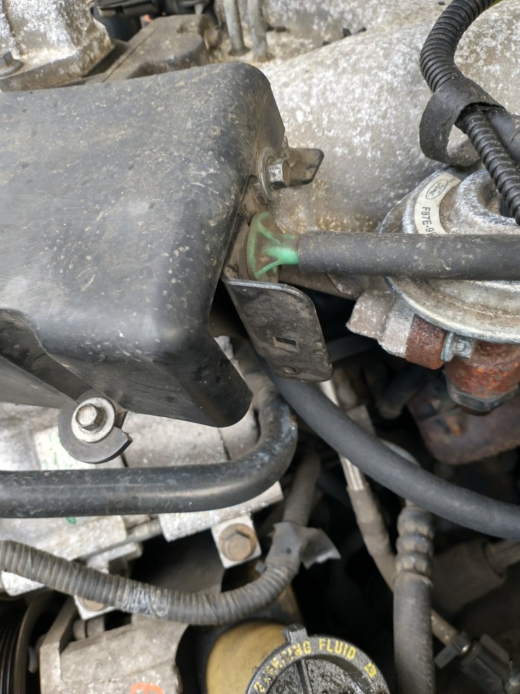

Thought I'd add some photos of my 1% build year 2000 rig. It might be so unusual that other people could want to see. Other pertinent info: the 11th character in my vin is a"P". Does that mean it was built-in St.Paul? and the month of build was 06/00.
  • Cruise Control kit, where can I get one?

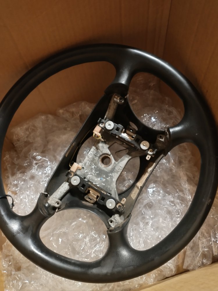

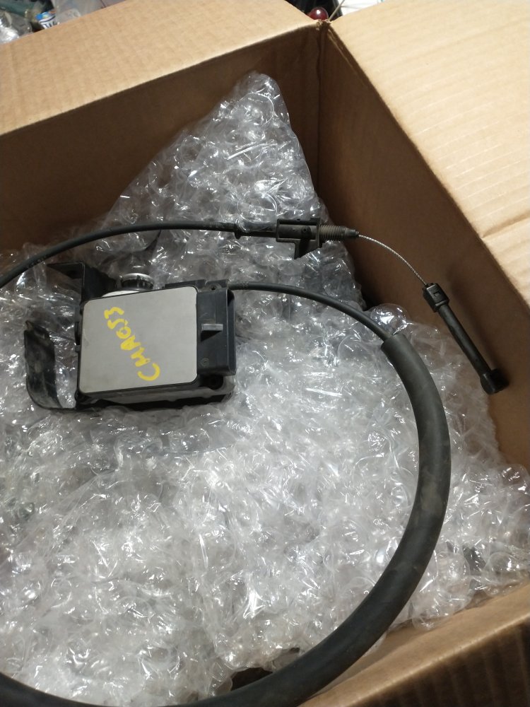

Last week before I discovered this route probably wouldn't work I called this wrecking yard that's about 200 miles away and asked for the parts to put the cruise control onto my year 2000 3.0L Ranger. I told them I would need the cable module with cables that connect it to the PCM and throttle mechanism. And I would need the electronic control switches and cables that are on the steering wheel.
This is what came today, should I be angry? The throttle mount looks broken, there's no electrical cable and the cruise controls on the steering wheel are completely missing, not even the hardware screws to mount them with. Having never seen what this stuff should look like, I'm feeling abit screwed over. How could this not be intentional?
I'll be driving past there next week. It was a phone transaction, so I'm sure it will come to a word game. Can anyone send a photo of what I should have received so I'll know what it looks like?

Hey, thanks for sharing the nicely made video showing how to add Cruise to an '80's truck. Not really what I'm needing, but it did include some useful tips to think about. I was wanting to know what the 2000 3.0L hardware actually looks like. I'm going to install that "Rostra" unit since the factory unit won't interface to my Ranger without changing a whole lot of other parts. But since I'm going to be driving by the junkyard place next week, I'll stop in and share my piece of mind with the jerks and probably get arrested, (I'm Irish with a bad temper). I'm going to first try to politely ask for a refund, since the parts they sent were obviously incorrect and broken and also since I've found out the parts won't do me any good anyway. I've got the 1% Ranger that never included cruise anywhere in the build.
