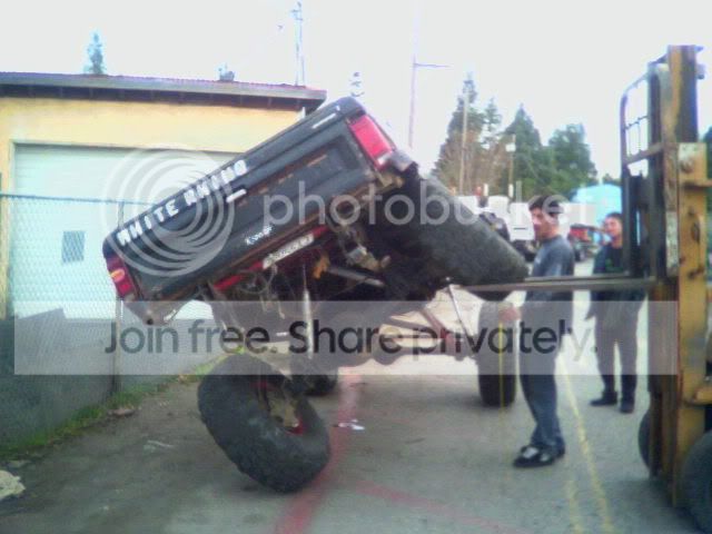

flex is over rated. Check out WhiteRhinos build on pirate. he had inboarded chevy's and had tons of flex.\
use sway bars with removeable links if you want stability at times
Yea, been followin that one pretty religiously. His setup looks like it works out awesome on the trail. Only thing he said is his isn't too hot on the road.
