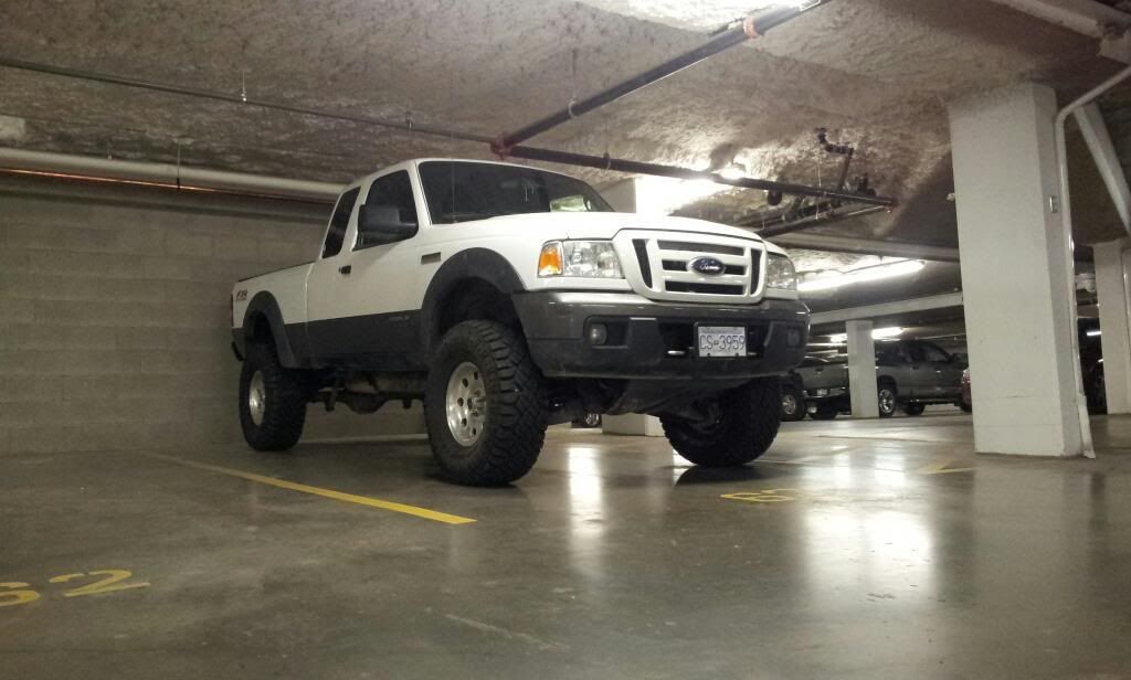

Now speaking realistically though - I live in a ROUGH part of Canada. 4x4 capital of Canada really... and I find that after what i've done to my truck - I don't need ANYTHING else now other than maybe a rear e-locker. Unless I am doing something REALLY stupid I don't need a bigger truck than what I have.
Unless you are looking for something like this: http://classifieds.castanet.net/showproduct.php/product/1050391/cat/5
You also may never need more than a ranger bodylifted on 33's. Just sayin'
Phone picture - Gives you an idea. Everything in my signature. No rub Anywhere. Totally functional.. Big enough to get over almost any obstacle - not too big that I can still fit in underground parking - drive throughs, and its not a total pain to get in and out of.

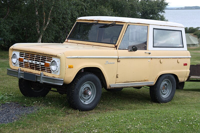

That one's growing on me too. Combines the best of both worlds. Removable top and four seats like the classic bronco, with the looks and power of the 70s F-series trucks (though I still prefer the bump sides). It's got one big advantage over the classic Bronco, that being the back seats are big enough for adults. If I go that route it will most likely get the 390, manual transmission and transfer case from the F-100 pictured above.
How about a bump-side Bronco?!?!
Yeah that would be a custom job there. They never made a Bump Side Bronco. The moved from bump to dent in 73 the FSB didn't come out until 78. I think I'd rather just stick with the dent side on those.
Yeah, i know. But you said you like the bump-side better. I was just giving you the option of the best of both worlds.
