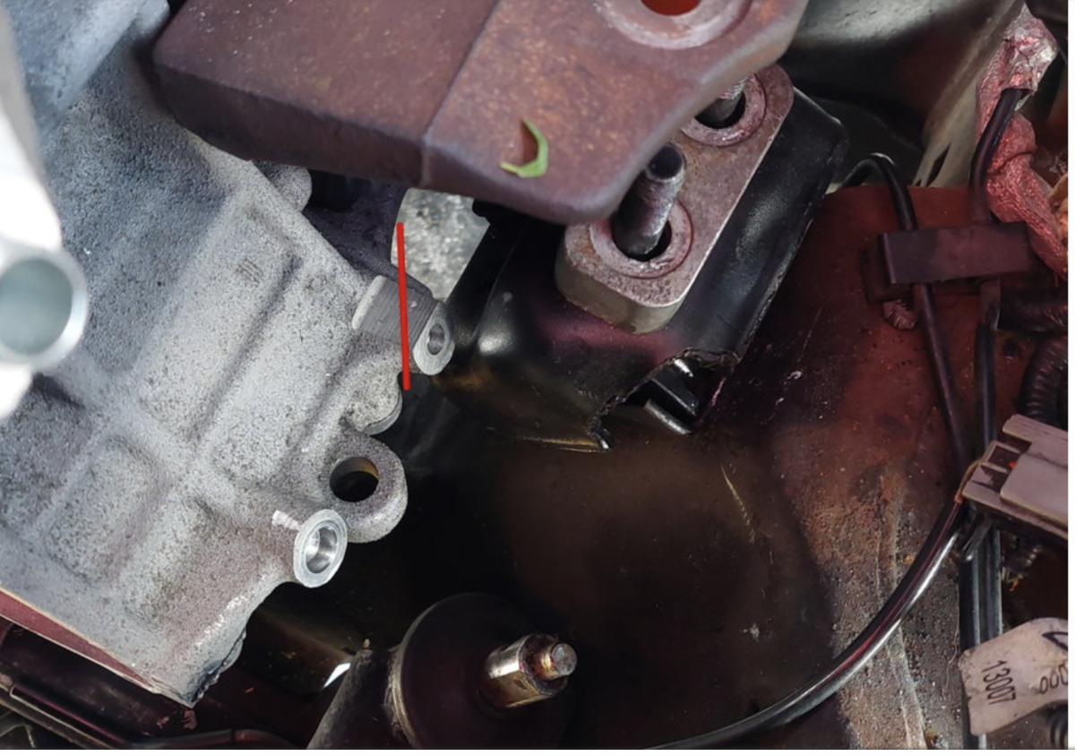

The Block modification he mentioned in his writeup was simply cutting off a small part. Photo, something about clearance with the motor mounts.

interesting, I'll check the block I have.
