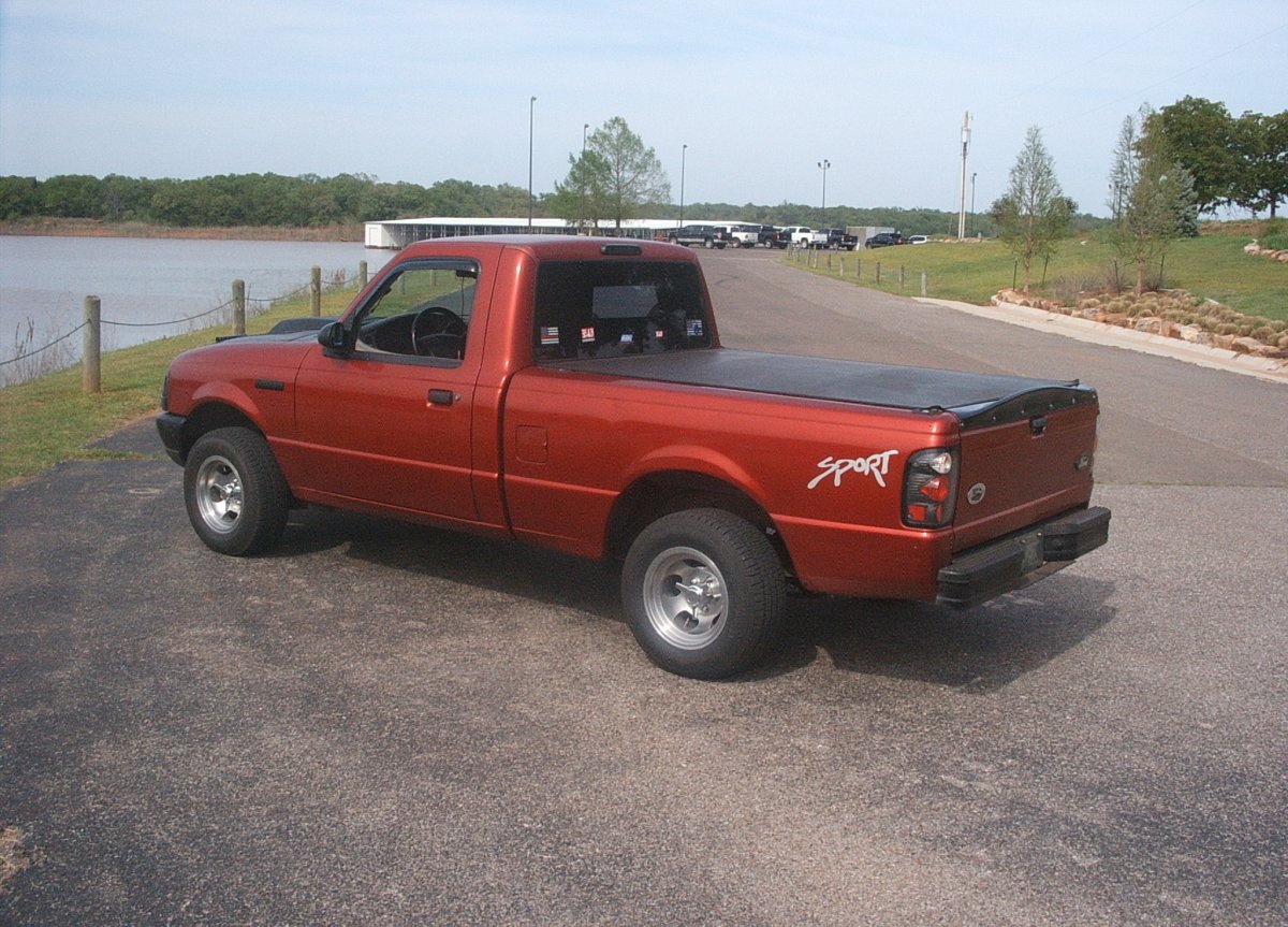

Got these in Monday. Last time I had these, the center stud could not make up it's mind whether to stay in the pedestal or the spinner. So, I threaded them fully into the spinners, put a drop of red Loktite on the threads and screwed them into the pedestal. Hour later, the spinners came off leaving the stud behind. Going to put a coat of wax on them today, then wait out Mother Nature. Looks like a stormy pattern ahead for a few days, including the weekend. DRATS!!

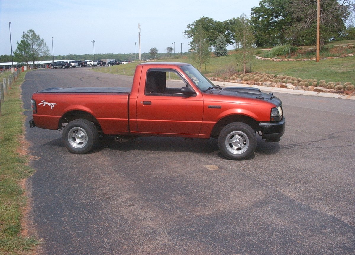

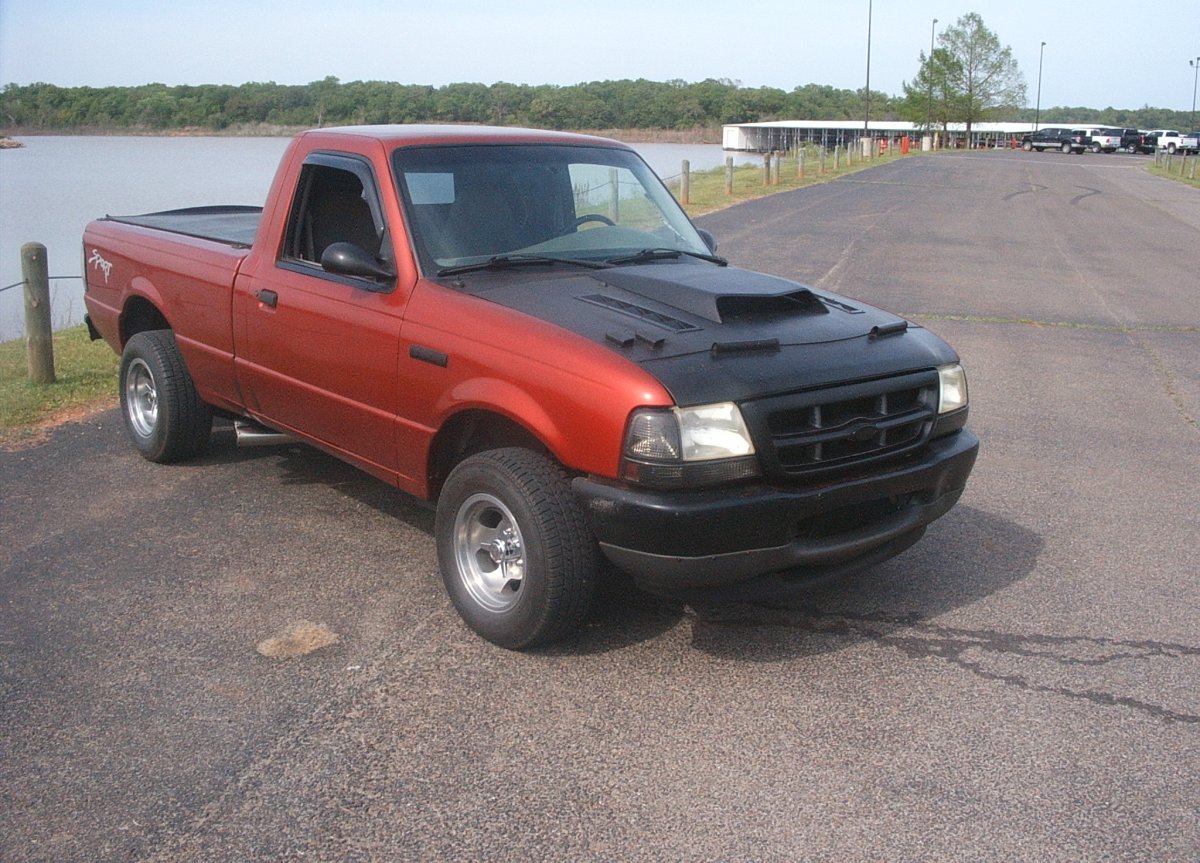

I get a lot of "you need to lower it." There's no easy way to lower a Ranger the little I would want to do. No more than two inches. But flipping the axle or shackles is going to be too much, at least for me. So, I'll live with it as is.

Explorer Rear end will drop the rear 4"-5", with 2" lift blocks on that , it will have you lowered about 2-3". You still have to figure out the front end though, since you don't have the torsion Bar suspension

Yeah they got the mafs a little off there. Adding "lift" blocks to an axle flip in a Ranger will lower it more. What is needed is extended shackles, that will raise it. Explorer leaf springs will too.
Flipping the axle is 4-5 inches and I can understand that being too much.
Flipping the rear hanger is about two inches. They also offer a little short shackles now that could bring that back up a bit after flipping the hanger, or a 1" lift block could be used. Just throwing out the options.
I personally would have to do one or the other if it were my truck, but it isn't.
Two inches I could live with. But how to lower the front to match?
Lowering springs? I would also consider possibly using drop beams, then a washer spring lift like the 4x4 would use.
Are the springs original? If so they have probably sagged over time. You could probably install best with NEW stock springs and net 2" drop.
Personally I'd just go shoot for a 3/4 drop. 3" beams in front and what ever got me to between 3 and 5 inches in rear. Raked or level is good for me, just no squatting.
