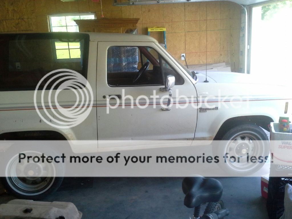

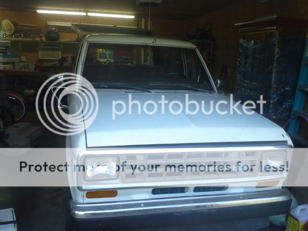

Got most of the interior tore out of the White B2. Pulling the engine soon. It will get new gaskets and go in the 88 Ranger I got for my son. Been gathering parts for it.
Still need a few more parts before I get started on the B2's, but I have decided to patch the frame and do a body swap instead of switching everything over to the 2wd frame.
