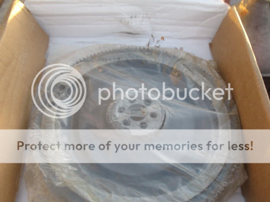

Got my new flywheel today.That 4.0 flywheel is pretty beefy.
new flywheel, yay!

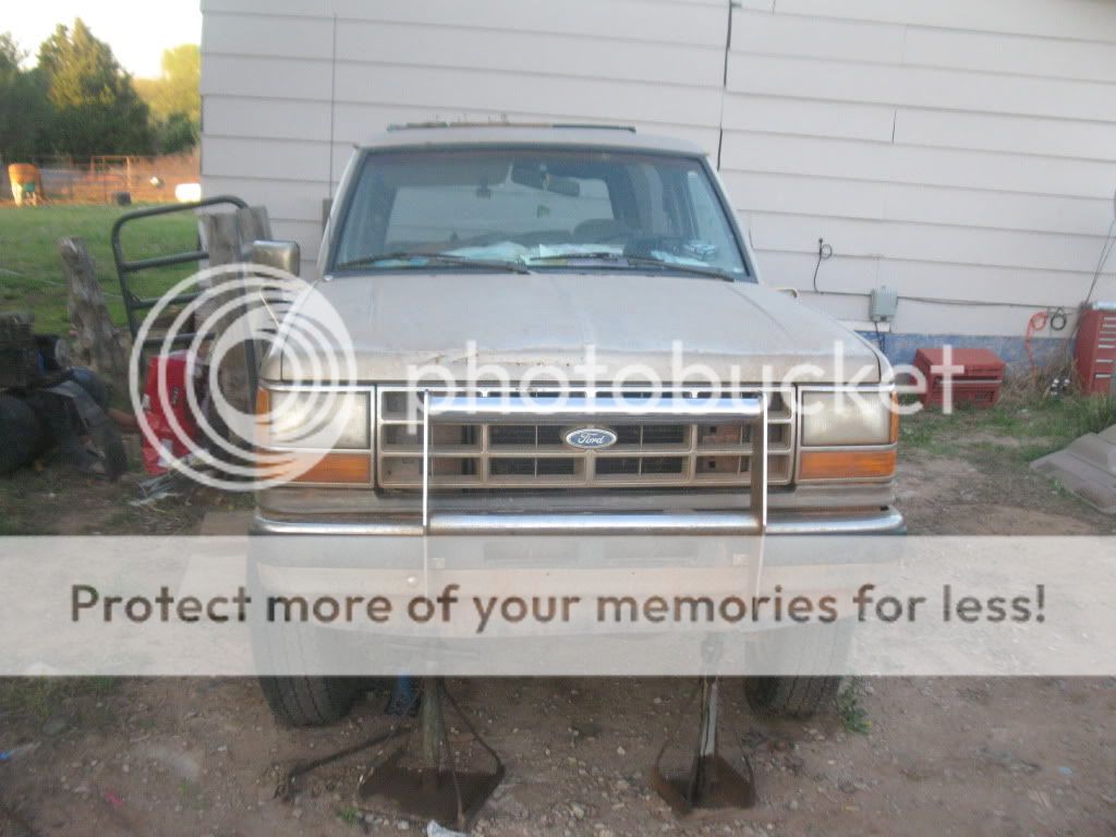

gwai has a b2 with a mid engine 460 its his wheelstander. and when you finish the paint if you havnt already my vote is for camo racing stripes i think thatd be awsome.
Got the tranny pulled out of tan.Took longer than expected, my chevy friends had a hard time workin on a RBV.
New clutch and flywheel installed. Tranny in and lined up. Got a few of the bolts in someof them seem too short.

Ran into that on my old BII I believe the 4.0 flywheel is a touch thicker and you need different bolts. Got mine from the dealer but you could probably find them elsewhere. Looking good though keep it up:icon_thumby:
